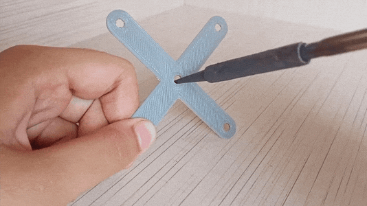

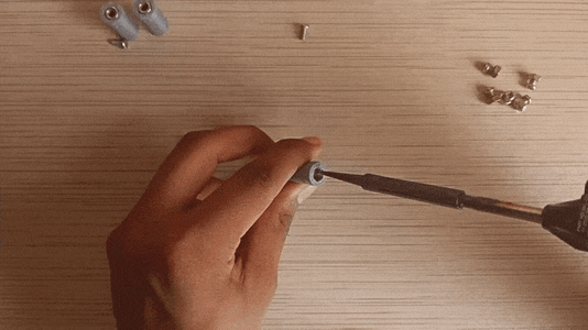

Firstly we will increase the size of holes on 3D prints.
  • Best way to do is to use a pointed tip solder iron.
  • Let solder iron heat enough.
  • Gently circle around inner perimeter of the hole about 5 revolutions is enough.
  • Doing so will melt the print enough to fit the parts firmly.
Now insert the hex nut in hex cavity, if they don't go enlarge the hole using solder iron.

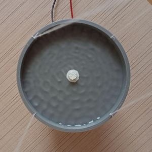

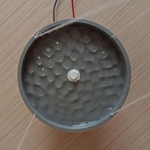

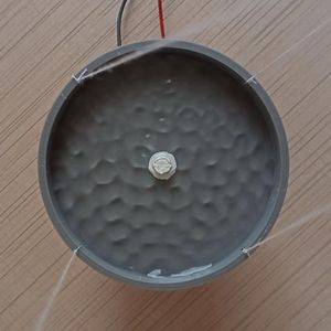

Step 9: Lets Generate Patterns!
Our system is more responsive over a frequency range of 40 - 90 Hz.
You can use this to generate audio signals of various waveforms and characteristics.
And we are done! Plug in, drive the speaker and admire the mesmerizing patterns generated.
