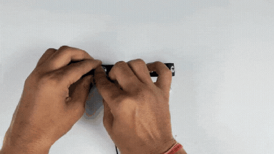

Measuring EMG using Muscle BioAmp Band, a dry electrode based EMG band:
  1. Connect the BioAmp Cable to Muscle BioAmp Band in a way such that IN+ and IN- are placed on the arm near the ulnar nerve & REF (reference) on the far side of the band.
  2. Wear the band on your arm as shown in the gif above.
  3. Now put a small drop of electrode gel between the skin and metallic part of BioAmp Cable to get the best results.
