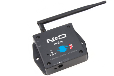

Graphs, Line Charts, Pie Charts etc. are an interactive way to visualize and analyse the Sensor data. In this instructable we will be featuring the use of Google Charts to visualize the Wireless Vibration and Temperature sensor data. These statistics can help us to take necessary possible steps after an early fault detection and eradicating the possibility of degradation of machines. We have seen in our previous instructables that how the wireless vibration and temperature sensors served different applications and helped us in fault detection and irregular vibrations in the machine.
In this instructable we will be serving a webpage from the gateway device and will be monitoring the sensor data using Google Charts. here we will be learning about the following:
  • Wireless Vibration and Temperature Sensors
  • Hardware Setup
  • Gathering the data using Wireless gateway device
  • Vibration analysis using these Sensors.

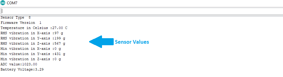

Step 3: Getting the Vibration Sensor Values
The vibration values, that we are getting from the sensors are in milis. These consists of the following values.
  • RMS value- root mean square values along all three axes.The peak to peak value can be calculated as
peak to peak value = RMS value/0.707
  • Min value- Minimum value along all three axes
  • Max values- peak to peak value along all three axes. The RMS value can be calculated using this formula
RMS value = peak to peak value x 0.707
  • Earlier when the motor was in good condition we got the values around 0.002g. But when we tried it on a faulty motor the vibration we examined was about 0.80g to 1.29g. The faulty motor was subjected to high rotor eccentricity. So, we can improve the fault tolerance of the motor using the Vibration sensors.

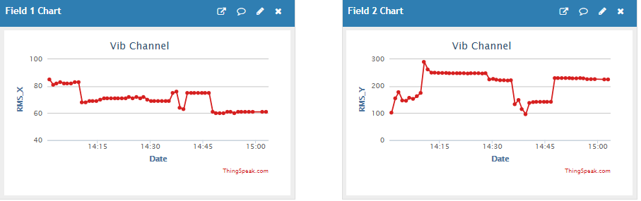

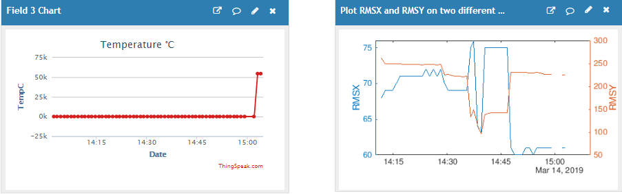

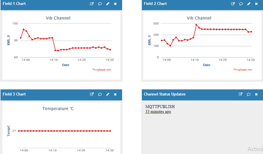

Step 5: Data Visualization
Google Charts provides very efficient way to visualize data on your website or static webpages. From simple line charts to complex hierarchical tree maps, the google chart gallery provides a large number of ready-to-use chart types.
Here we have made an User interface to analyse sensor data using Google Charts . It works as following.
  • Open the local WiFi IP on the webbrowser. Webpage is served at this IP.
  • Select the sensor type from the drop down list. There are different sensors available in the list.
  • Then create an event for email notification or mobile notification. using IFTTT. to know more about IFTTT and webhooks and the setup go through this blog.
  • Then hit submit button . Once you hit the Submit button, Thingspeak API will be called by the function. it pulls the sensor reading from thing speak in JSON format. This JSON data will be parsed to get the real values of vibration.
  • The graph will show up on left side of webpage.
