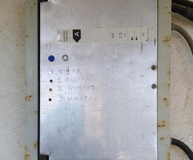

There are plenty of Smart Weather projects, but none of them can show the weather conditions using LEDs. That’s why I named this project 'Visualization of the Weather'. According to the description of the weather conditions provided by OpenWeatherMap, the program lights up the corresponding LED. Additionally, it inhibits watering in case of a rainy day. I preferred this method, which relies on a web page instead of a sensor, as sensors can send erroneous data to the microcontroller due to corroison or dust or moisture. Besides this, the program is an IoT project designed to provide real-time monitoring and data collection for weather conditions and water usage. This project leverages various sensors and modules to gather information about temperature, humidity, atmospheric pressure, wind speed, wind direction, and water flow. The collected data is displayed on a TFT screen and transmitted to thingSpeak for remote monitoring and analysis. Public channel thingspeak with user id:nikakis30.

This Arduino program is designed to assist an irrigation system controlled by a Nano Arduino module. Although it could be merged into one, I preferred to keep it separate for hardware simplicity because the TFT alone requires seven wires. I wanted it to be as compact as possible to place it on the lid of the box housing the entire project. The additional feature of this program is to control a water flow valve to inhibit watering in case the weather is rainy. The other features provide statistical data and allow monitoring the system's functionality from a distance. The program can visualize the weather conditions using LEDs corresponding to the actual weather conditions. For example, if the sky is clear, it lights up the LED for clear sky; if it is rainy, it lights up the rain LED, and so on. The data is retrieved from OpenWeatherMap. Besides turning the LEDs on and off, the program also opens or closes an electrovalve attached to the water supply.. For this project, I use an ESP32s microcontroller to monitor weather conditions, water flow rate, and total water consumption. It features a TFT display for real-time data visualization and integrates with ThingSpeak for remote data logging. The system also connects to an NTP server for accurate timekeeping and retrieves weather data from OpenWeatherMap.
