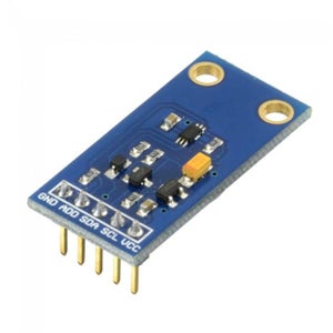

  • Arduino UNO or Arduino Mega (or any other board)
  • BH-1750 ambient light sensor

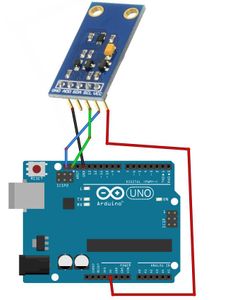

Step 2: The Circuit
  • Connect BH-1750 Sensor pin [SCL] to Arduino pin [SCL]
  • Connect BH-1750 Sensor pin [SDA] to Arduino pin [SDA]
  • Connect BH-1750 Sensor pin [VCC] to Arduino pin [5v]
  • Connect BH-1750 Sensor pin [GND] to Arduino pin [GND]

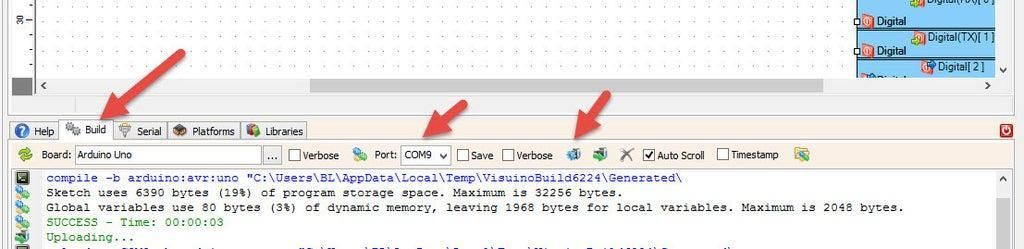

Step 3: Start Visuino, and Select the Arduino UNO Board Type
Start Visuino as shown in the first picture Click on the "Tools" button on the Arduino component (Picture 1) in Visuino When the dialog appears, select "Arduino UNO" as shown on Picture 2

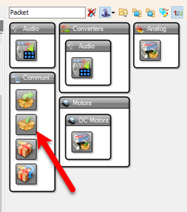

  • Add "Packet" component

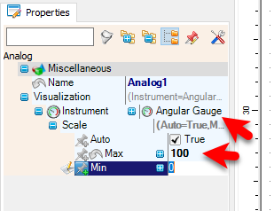

  • Select "MapRange1" and in the properties window set "Input Range" > "Max" to 54612 and "Output Range" > "Max" to 100

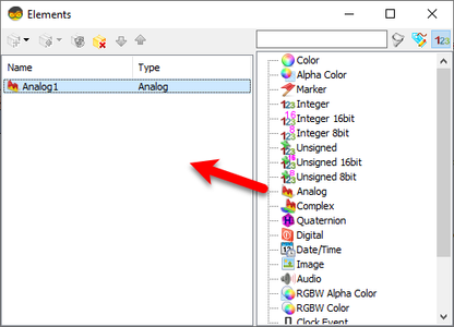

  • Double click on "Packet1" and in the Elements window drag "Analog" to the left side and in the properties window set "Visualization" > "Scale" > "Max" to 100
Note: you can adjust the MapRange1 output Max and Packet1 Analog1 Scale Max according to your needs

Step 7: Generate, Compile, and Upload the Arduino Code
