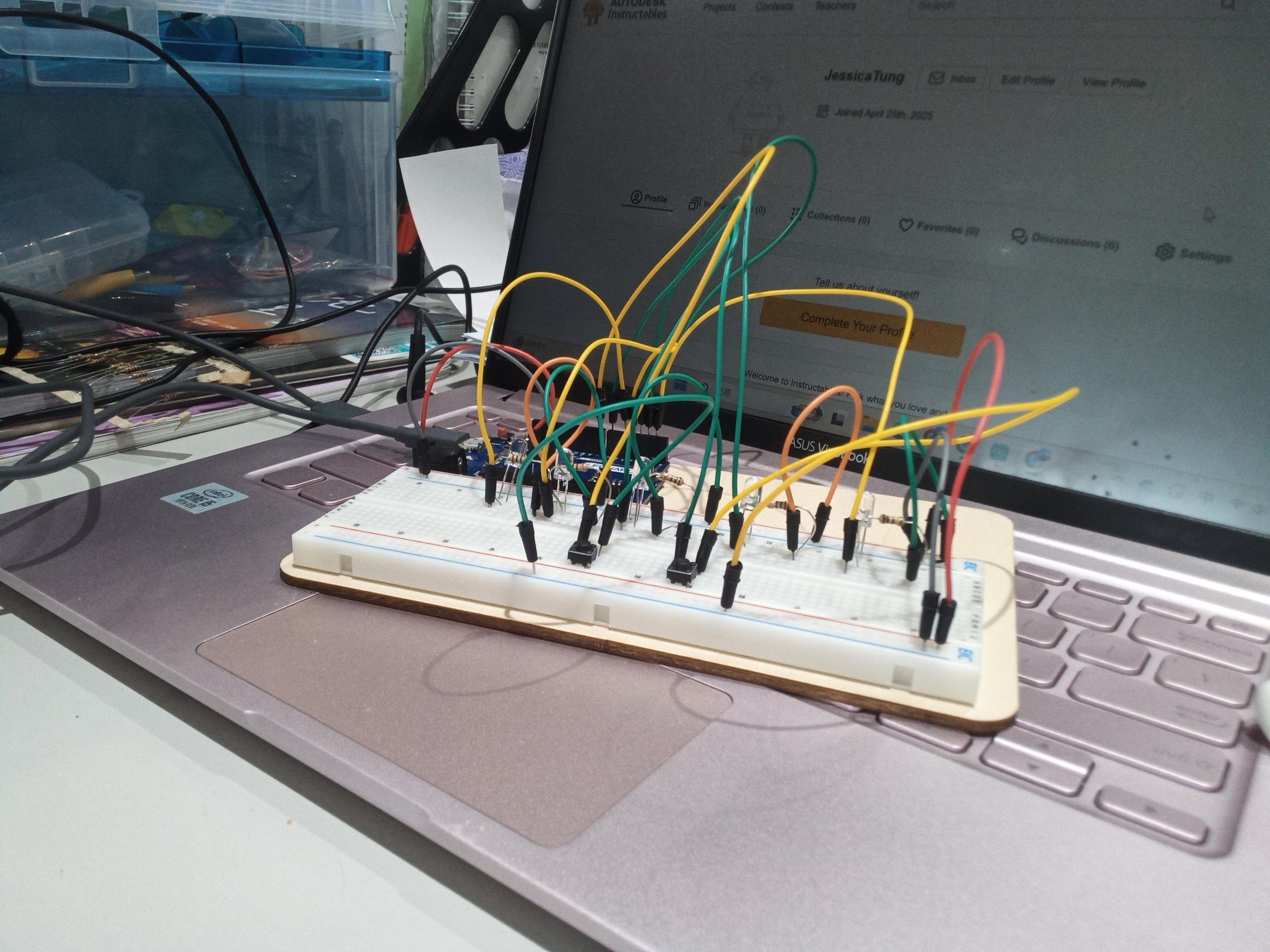

Step 1: Connect the Stepper Motor
  1. Connect the stepper motor to the ULN2003 driver board.
  2. Use jumper wires to connect:
  3. IN1 → Arduino pin 2
  4. IN2 → Arduino pin 3
  5. IN3 → Arduino pin 4
  6. IN4 → Arduino pin 5
  7. VCC of ULN2003 → Arduino 5V
  8. GND of ULN2003 → Arduino GND
Step 2: Connect the Buttons
plug the 5-wire connector from the 28BYJ-48 stepper motor into the white socket on the ULN2003 driver board. It only fits one way.
Use the ULN2003 driver board to connect your stepper motor to the Arduino. This motor will rotate to show new words.
