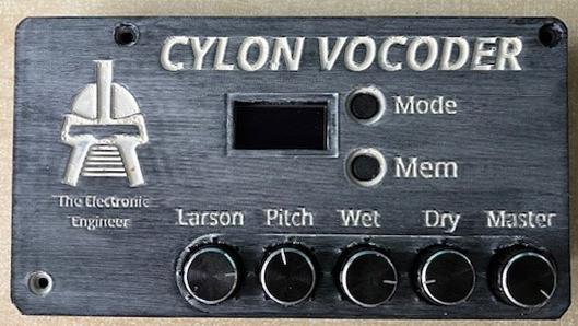

The vocoder I build uses a Teensy Microcontroller and a external audio chip. Using some very well crafted coding ( the Teensy Audi library) I was able to emulate a vocoder that delivers. Not only can it make your voice sound like a Cylon, it als included the larson scanner ( the moving eye) it even emulates the mechanical sound of the moving eye,,,,WHOOS...WHOOS...

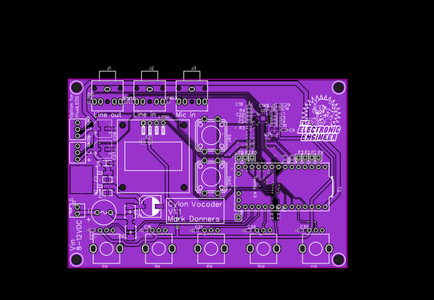

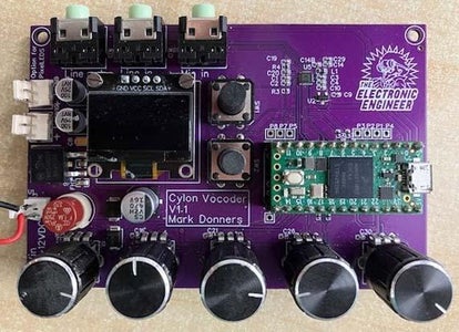

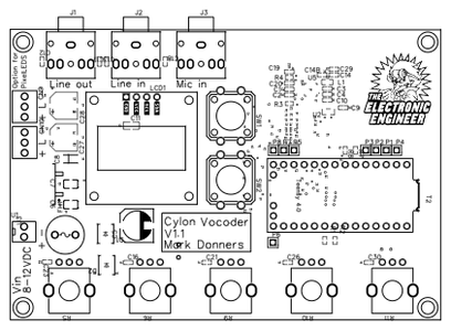

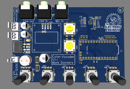

Step 2: The PCB
You can order a pre assembled pcb. All the small components are already assembled. All you need to add is a display, the Teensy controller, potentionmeters and maybe a few headers/sockers.
If you are using the schematic and gerbers to have a pcb produced elsewhere, you will have to add the rest of the components as well. See the pcb bom list.

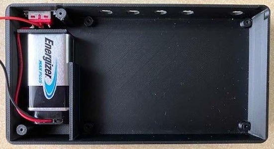

Step 3: 3D Printed Housing
I designed a nice housing that also has room for a battery. The housing is already designed to fit the next version of the pcb that has extra Jack connectors.
You can print your own housing. Files are included.

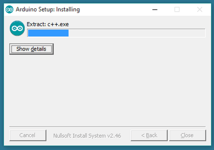

Step 5: The Arduino Sketch and Setup

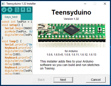

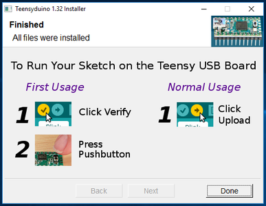

Installing the Teensy Framework
Before you can compile the sketch successfully, you will need to install the Teensy plugin and some libraries
I used Arduino IDE with Teesyduino:
- Arduino IDE 2.3.4
- Teensyduino, Version 1.59.0

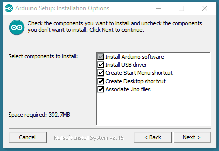

You can download ARduino here: ARduino IDE Download
Click here for a tutorial about installing Arduino
Make sure you use the Arduino IDE and not the windows app ( incompatible with the Teensyduino )
You can download Teensyduino here: Download TeensyDuino
Click here for a tutorial about installing TeensyDuino

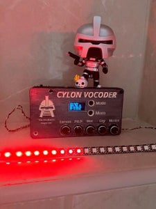

Step 6: Demo
I made a small video of what this vocoder can do. In this demo, I tuned it to sound like a Cylon. It's easy to change Pitch of the mix of Wet and Dry sound as well as volume. Th volume of the Larson Scanner ( the red moving light) can be changed also.
