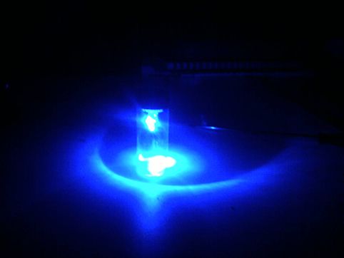

Introduction: Vodka Bottle Lamp (Using LEDs)
This is a cool little LED lamp that is surprisingly bright and looks cool in any room. The frosted glass of the vodka bottle makes the glowing effect all the more smooth. This is quite a tricky make and will take a lot of patience.

Step 3: Insert the Circuit
The next step is to get the circuit into the bottle. Before we do this, however, it would be a good idea to test the mini circuit. This can be done with some scrap wire and a 9V battery. Now you know your circuit works you can move on to getting it in the bottle.
First of all you must cut the end off the 9V adapter and expose the the wire inside. There should be a red and a black wire inside the adapter wire. The red is the positive and the black is the negative. If your wires are different colours, you can test which one is the positive and the negative using a multi-meter or make a little conductivity test circuit using a resistor and a LED. LEDs only let power flow one way so if it lights up the wire closest to the resistor is the positive.
Once you have exposed the wires and you know which is the positive and which is the negative you can insert them through the hole drilled in the vodka bottle and pull the wires out through the top opening.
Next, simply solder the wires in their correct locations on your protoboard circuit.
Now comes the tricky bit. You must get it into the bottle and stick it to the inside wall of the bottle so that it is hidden behind the label.
To do this I used a chopstick with some blue-tack on the end to move the circuit when its in the bottle. Start by applying a healthy blob of glue to the underside of your circuit. Then, with sticky-chopstick in hand, push all the wires and circuit into the bottle. Use the chopstick to manipulate the circuit into position. It helped me to turn the bottle on its side so I could push the circuit down onto the target location. Apply a little pressure until it will stay in place on it's own. This took way too long for me so I used some small weights to hold the chopstick in place for me. Leave for at least 24 hours before moving the bottle or chopstick.
Step 4: Adding the Switch
Now the glue is dry we can safely move the bottle about and add the switch.
This is a simple procedure. Start by selecting where in the adapter wire you want the switch and cut the wire at that point. Expose the inner wire on both ends so you end up with four exposed wires.
Open up your switch unit using a screwdriver. you should see four holes with little screws on top for clamping wires into. Clamp your wires into the holes and tighten the screws so that the wires do not move. It does not matter which way the wires go so land as the opposite wire has the same polarity or symbol. In other words, make sure the red wire is opposite the other red wire and the black is opposite the other black wire.
Once the wires are clamped in place you can put the switch unit back together. Plug in your new lamp and turn it on!
