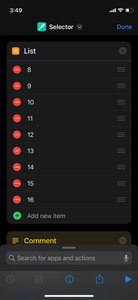

In the example images, there is a list at the very top of the shortcut. This step is optional as it acts as a secondary safeguard against sending the wrong data.

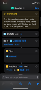

  • Then, type "dictate text" into the search bar.
  • There should be a dictate text function that shows up.
  • We will start with this to start as it will allow you to use your voice to create a variable containing whatever you said while the shortcut was active.
  • Next, create an If statement with the dictated text variable and set it up so that, if the dictated text contains a key word - in my case "mm" - (continue to the next step)
  • In the search bar, search for text. Once you have it, insert it just below the if statement and insert the "dictated text" variable into it
  • Because we want to isolate the integer in the dictated text, place the "replace" function under the text box.
  • Set the replace function so it will replace your key word (in my case "mm") with nothing in order to isolate just the integer.
  • This new text variable will be called "updated text"
  • OPTIONAL - Create a List that goes at the very beginning and include the values that you will only use.
  • Place an if statement after replace function (the step before this) and set it up so that: If the List contains the Updated Text, then... (continue to the next step)

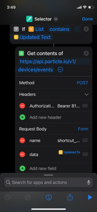

  • In the search bar, search for "Get Contents Of" and place that next.
  • (If you DID do the optional step, place this webhook inside of the if statement that you created during the optional step)
  • Setting up the webhook gets complicated to bear with me. (please refer to the images for clarification)
  • First you need to create the webhook through the Particle Integrations.
  • Select "Webhook" as that is what we are creating then "Create New"
  • Name your event whatever you want. For example: "Selector"
  • Before creating your URL, you need to get your Access Token.
  • Go to the link, sign into your Particle account and scroll down to get your access token.
  • You will also need the name of your Particle Argon.
  • To do this, go to the Particle IDE and navigate to the "Devices" Page on the left side.
  • Use the following template in for the URL box:
  • "https://api.particle.io/v1/devices/[Name of Your Device]/[Event Name]/?access_token=[Access Token]"
  • Next, make the request type, "POST"
  • The request format should be "web form"
  • The devices should be set to "Any"
  • Finally, the status can be enabled or disabled
  • Next, in your shortcuts app:
  • Delete any variables in the very top box where it says, "Get Contents Of: [ URL ]"
  • In the empty space for the URL, paste the following: "https://api.particle.io/v1/devices/events"
  • Change the Method to a Post request NOT a get request
  • Add a new header:
  • For the Key, input, "Authorization"
  • For the Text, input, "Bearer [Access Token]"
  • Add two new fields:
  • The Key for the first one should be, "name"
  • The Text for the first one should be, "[Event Name]"
  • The Key for the second one should be, "data"
  • The Text for the second one should be the "Updated Text" Variable
