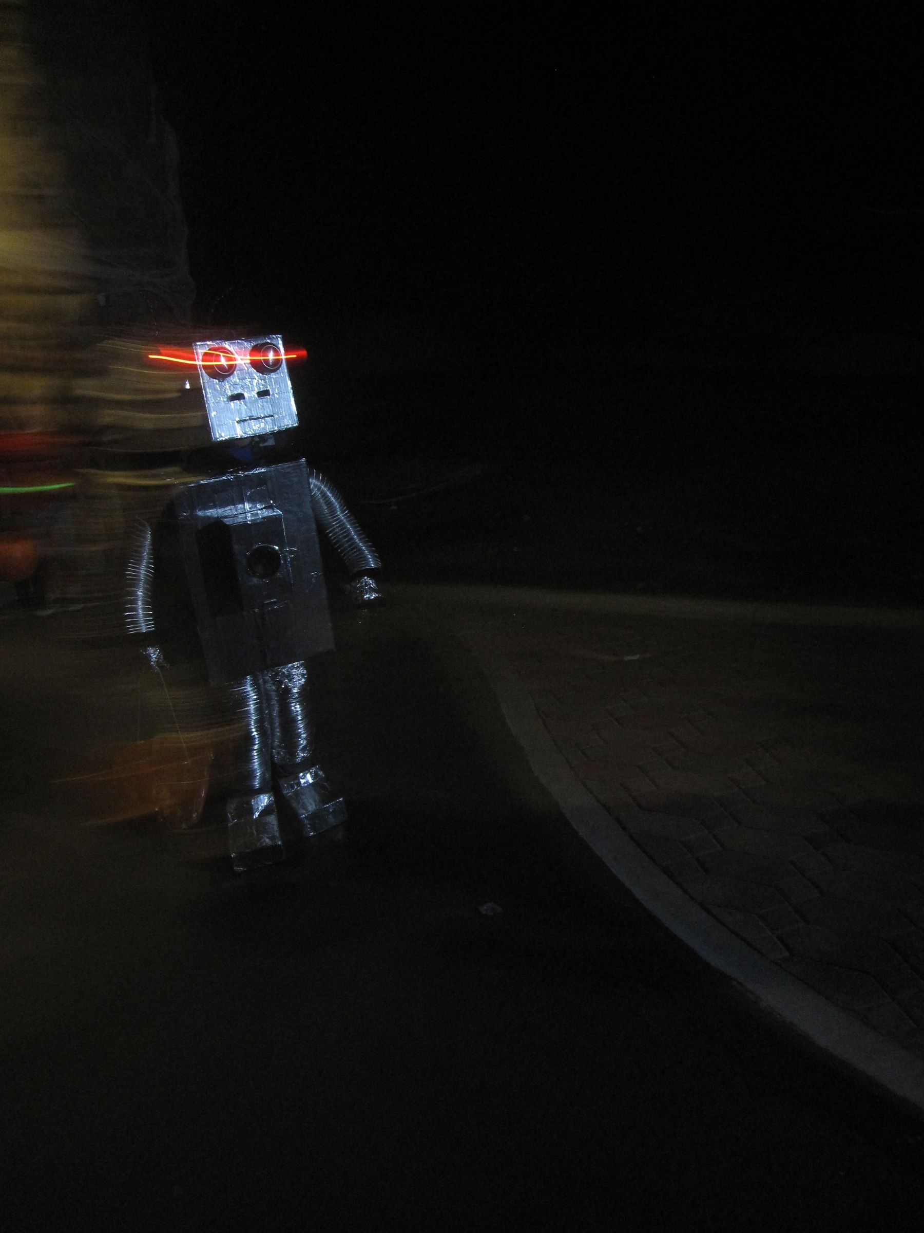

We made this robot costume about 3 years ago for our 7 year old at the time, and posted a photo of it here last year. Since then I've received numerous requests to explain how it was done in a step by step. I still have most of the robot sitting in my office, so I took some more photos, and dug up some schematics so you get a better idea of how you can make your very own!

Step 3: The Head, Part 1
The actual head itself, like the body is pretty simple. We used a box that held a 12 pack of beer bottles, it seemed to be the perfect size for our young robot.
You will need to find a creative way to keep the box snug on the wearer's head. We had him wear a big fluffy winter hat and stuffed other bits of rags and other fabric around the hat to keep it stable. We ended up having to add vent holes on the sides to allow our robot to hear.
The electronics were placed on the top, and covered with plastic just in case it rained, and to keep young hands off of the electronics.
