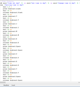

Step 3: Putting It All Together!
Now here is a simple voice command where GlovePIE will type out hello for you in Minecraft!(assuming that your button for opening the chat is C) Once you are done coding your program, press the little green arrow button at the top of the window to run it!
If said ("say hello", 5) then
Say("saying hello")
Wait 1.5 S
Press keyboard.C
Wait 15 ms
Release keyboard.C
Wait 15 ms
Press keyboard.H
Wait 15 ms
Release keyboard.H
Wait 15 ms
Press keyboard. E
Wait 15 ms
Release keyboard.E
Wait 15 ms
Press keyboard.L
Wait 15 ms
Release keyboard.L
Wait 15 ms
Press keyboard.L
Wait 15 ms
Release keyboard.L
Wait 15 ms
Press keyboard.O
Wait 15 ms
Release keyboard.O
Wait 15 ms
press keyboard.Enter
Wait 15 ms
Release keyboard.Enter
Wait 15 ms
End if
