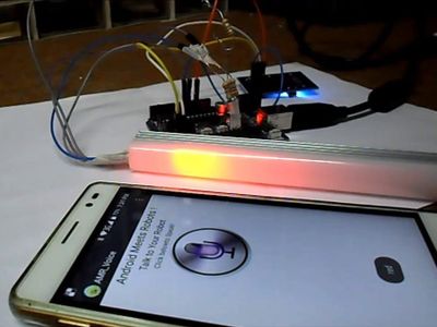

Introduction: Voice Control RGB Led Using Bluetooth & Arduino
Simple voice controlled RGB Led colour using Arduino and Android device connected via Bluetooth
Step 1: Components Needed
1-Arduino
2-RGB led
3-bluetooth
4-breadboard
5- wires
download AMR-VOICE APP FROM APP STORE ON YOUR PHONE
Step 2: Circuit Diagram
Step 3: CODE
Rayan Kiwan
//Coded By: rayan kiwan(2/7/21) //Voice Activated Arduino (Bluetooth + Android) //Feel free to modify it but remember to give credit
String voice;
int led1 = 10; //Connect LED 1 To Pin #10
int led2 = 9; //Connect LED 2 To Pin #9
int led3 = 8; //Connect LED 3 To Pin #8
//--------------------------Call A Function-------------------------------//
void blue(){
digitalWrite(led1, HIGH);
digitalWrite(led2, LOW);
digitalWrite(led3, LOW); }
void green(){
digitalWrite(led1, LOW);
digitalWrite(led2, HIGH);
void red(){
digitalWrite(led3, HIGH);
digitalWrite(led1, LOW); }
void yellow(){
void white(){
digitalWrite(led1, HIGH); }
void black(){
void setup() {
Serial.begin(9600);
pinMode(led1, OUTPUT);
pinMode(led2, OUTPUT);
pinMode(led3, OUTPUT); }
void loop() {
while (Serial.available()){ //Check if there is an available byte to read
delay(10); //Delay added to make thing stable
char c = Serial.read(); //Conduct a serial read
if (c == '#') {break;} //Exit the loop when the # is detected after the word
voice += c; //Shorthand for voice = voice + c }
if (voice.length() > 0) { Serial.println(voice);
//-----------------------------------------------------------------------// //----------Control Multiple Pins/ LEDs----------// if(voice == "*blue") {blue();}
else if(voice == "*green"){green();}
else if(voice == "*red") {red();}
else if(voice == "*yellow") {yellow();}
else if(voice == "*black") {black();}
else if(voice == "*white") {white();} voice="";}} //Reset the variable after initiating
