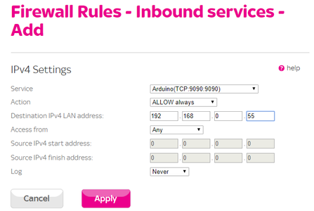

First we will make our Arduino accessible from anywhere on the internet, using Port Forwarding on your local router.
To do this you will need to set your Arduino to a Static IP Address (or add a Reservation for its MAC on your Router).

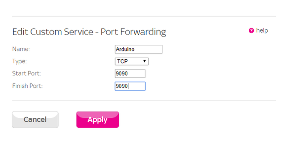

Then we will need to decide on a port (e.g. 9090) to serve our Arduino Webserver on (80 is in use by your routers' web interface externally normally, you can use this so all requests hit your Arduino without any other changes).
Once that's decided we can add a Service which defines the port ranges, and then add it as a rule to allocate it to the IP address from the previous step.
Now that's configured you can access it via the External IP of your router (available on your Router or at https://www.whatismyip.com/) with a Port e.g. http://90.98.241.123:9090, however as there is no device running you will just get a 404 at the moment.

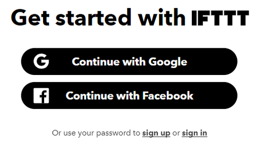

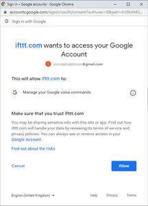

First register with IFTTT with the same Google Account as on your Assistant device.
(If you don't use the same account it will not work)

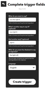

At this point you can configure different phrase types, in this example we will use a word "On" or "Off" as our variable, in the phrase "Turn the light On/Off" which we enter as "Turn the light $"

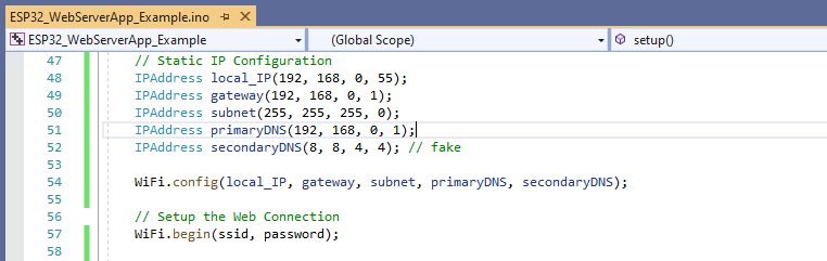

1) Add Static IP Configuration before Wifi.begin
// Static IP Configuration
IPAddress local_IP(192, 168, 0, 55);
IPAddress gateway(192, 168, 0, 1);
IPAddress subnet(255, 255, 255, 0);
IPAddress primaryDNS(192, 168, 0, 1); IPAddress secondaryDNS(8, 8, 4, 4); // fake
WiFi.config(local_IP, gateway, subnet, primaryDNS, secondaryDNS);

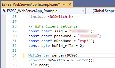

1) Amend Web Server Port & MDNS service binding to the same port as in step 2
WiFiServer server(9090);
MDNS.addService("http", "tcp", 9090);

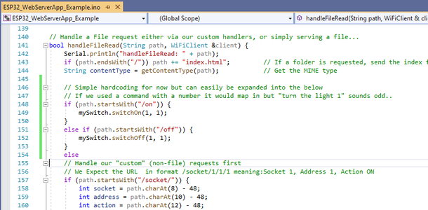

2) Amend URL Binding for our On and Off calls from step 3
in "handleFileRead(String path, WiFiClient &client)" there is a new case added for when path.startsWith("/on") and path.startsWith("/off")

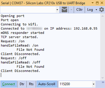

Now you should be able to say to your assistant "Hey Google, turn the light On", and it will respond with the phrase you said.
The light should also be on now as well!
You will also see in your Serial Monitor that there is a request sent in with the On Keyword appended to the URL, and your Arduino will have sent the RF message to turn the light on from the code changes.
