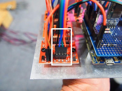

Step 2: Circuit Diagram
The circuit diagram for the robot hand is shown in photo 1
The matching motor / Bluetooth shield is shown in photo 2
The Big Easy Drivers are shown in photo 3.
The Big Easy Driver motor controllers support daisy-chain wiring
Motor Wiring
It may be necessary to reverse the two center wires from each 17HS3430 Nema17 12 volt stepper motors as the Big Easy Driver v1.2 A4988 stepper motor driver boards expect the wires from each of the coil-windings to be adjacent.
To achieve this it is necessary to swap the two center wires from each motor (photo 4).
The default color sequence for the 17HS3430 cables (for my motors) is red, blue, green, black. The color-sequence following the modification is red, green, blue, black.
The red, green winding is connected to the “A” terminals of the Big Easy Driver.
The blue, black winding is attached to the “B” terminals of the Big Easy Driver.
Big Easy Driver Current Limits
The current-limit on each of the Big Easy Drivers must be set to 400mA (milli-amperes) .
To achieve this:
- Switch off the power [1]
- Unplug your Arduino
- Unplug each motor cable
- Turn each of the current-limit potentiometers on the A4988 Big Easy Driver Boards fully clockwise
- Apply 12 volts to the Big Easy Drivers ... you should get a current reading between 90mA and 100mA. This is the current being drawn by LEDs.
- Turn off the 12 volt supply [1]
- Plug the “Thumb” motor in, apply power, and adjust the supply current to 490mA
- Unplug the Thumb motor.
- Repeat steps 6, 7, 8, 9 for each of the remaining motors
Plug all motor cables in to their respective controllers.
The total supply current will be just over 2 amps when power is applied
Note
[1]
NEVER plug, or unplug, a stepping motor with the power applied. The inductive “kick” (voltage spike) is likely to damage the controllers.

Each finger is cable-operated. Nylon fishing line is used for the tendons each of which are fed through a length of flexible curtain-wire.
Photo 2 in the Intro section shows two cables ... one with 2 tendons ... the other with three. This is okay if the bending radius is large otherwise the fingers tend to stick when the cables are flexed. This was overcome by using five separate cables in the video
While nylon fishing line works it tends to stretch. Stainless steel fishing trace would be a better choice ... I have a reel on order.
The actuators are made from stepping motors and endless belts. The tendons are attached to the drive-belts by means of a cable-ties.
This project should work equally well with servo motors. Minor code changes will be necessary if you choose to use servos.
