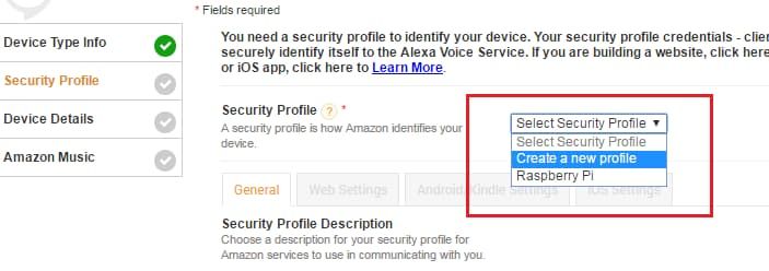

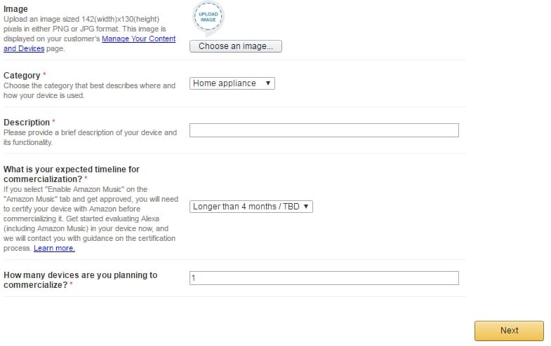

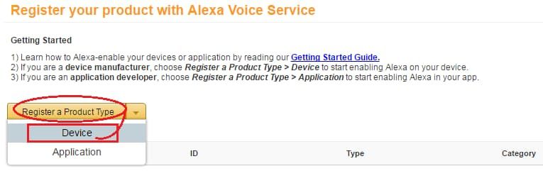

Step 3: Setup Alexa Voice Service
If you are not already enrolled, setup an Amazon Developer Account which will allow the development of Alexa Voice Service and many more. Follow the link: https://developer.amazon.com/home.html

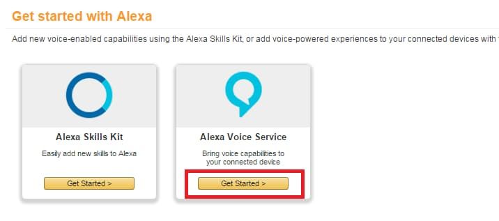

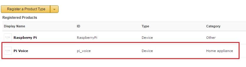

1. Log in to Amazon Developer Console and get started with Alexa Voice Service.

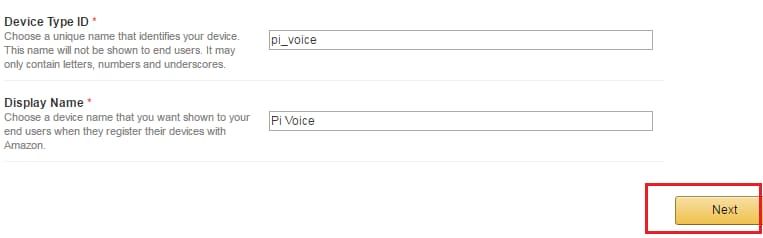

2. Click to Register a Product Type and select Device.
3. Give a Device Type ID and Display Name and then click to Next.

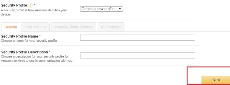

4. Select Create a new profile from the drop down.
5. Choose a name for the Security profile and give a description and then click to Next.
6. Your Security profile is ready. Click to Next.

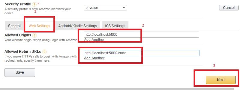

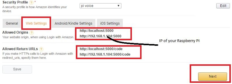

7. Click Web Setting tab and configure it like the picture below.
8. Click to Add Another and add the IP address of your Raspberry Pi.

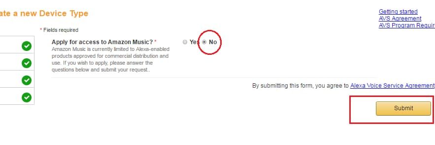

9. Put necessary information and click to Next.
10. Select No and Click to Submit.
10. You are now successfully registered to Alexa Voice Service.

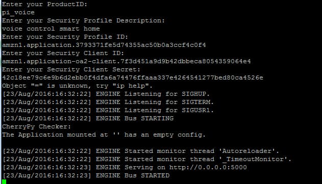

Step 4: Turn Your Raspberry Pi Into Alexa Client
Full instructions to make your Pi into an Alexa Client is available in AVS official Github page (https://github.com/amzn/alexa-avs-raspberry-pi) but I found it more easy to Sam Machin Github page (https://github.com/sammachin/AlexaPi).

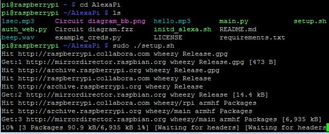

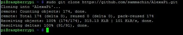

1. Clone the Github repo to your Pi typeing the following command into terminal:
sudo git clone https://github.com/sammachin/AlexaPi.git
2. Go to AlexaPi directory and Run the setup script:
./setup.sh

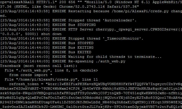

3. Wait for a while to ask your security profile information. Enter all information (product ID, Security profile ID, Client ID etc.) from the security profile of AVS when asked.

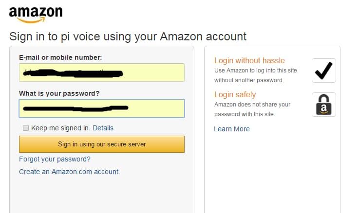

4. Open your browser and type your Pi's IP address with port 5000 e.g. (http://192.168.1.104:5000). Just replace IP with your own.
You'll be taken to a Login with Amazon web page. Enter your Amazon credentials.

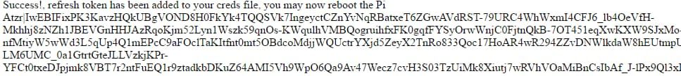

5. You'll be taken to a Dev Authorization page, confirming that you’d like your device to access the Security Profile created earlier.
Click Okay. You will see following response into browser
and like following to the terminal.
Congratulation!!! Your Raspberry Pi is now ready to work as Amazon ECO. You only need to connect a USB microphone to the USB port of Raspberry Pi and a button to GPIO 18 to talk to it.

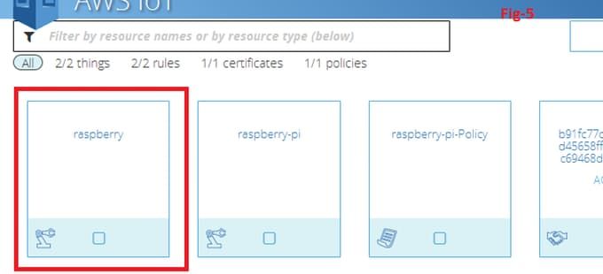

Step 5: Setup AWS IoT
All services in AWS are delivered via a rich set of REST APIs. You can use a service programmatically through the APIs by leveraging one of the many SDKs. You can use AWS cli. Alternatively, you can invoke services through the web-based AWS Management Console. To build my AWS environment, we will invoke AWS Management console. But keep in mind that every step we perform today can be done completely programmatically, which is one of the many reasons why the AWS cloud is so powerful. Follow the steps:
1. Create an AWS account from the link: http://aws.amazon.com/

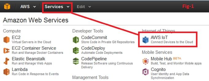

2. Sign in to AWS Management console and from the Services select AWS IoT (Fig-1).

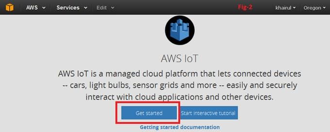

3. Click on Get Started (Fig-2)

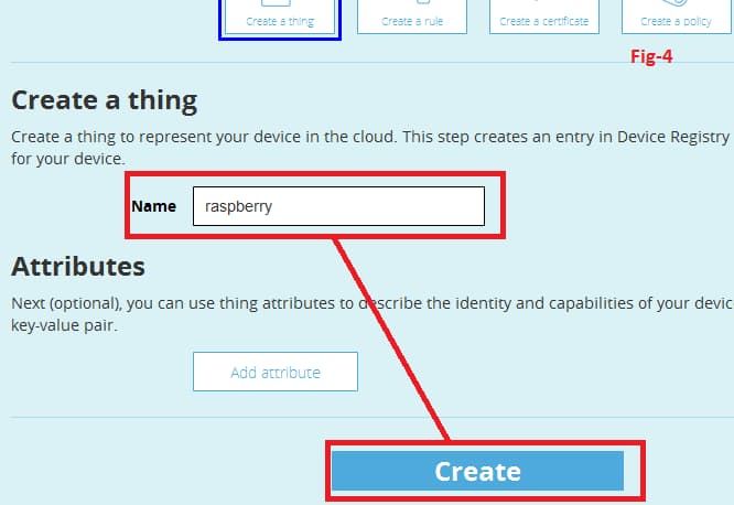

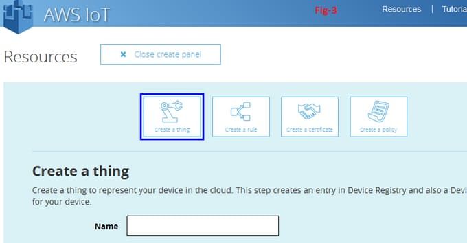

4. Click on Create a thing
5. Type a thing name (e.g. raspberry) & click to Create
6. A thing named as raspberry will be created (Fig-5)

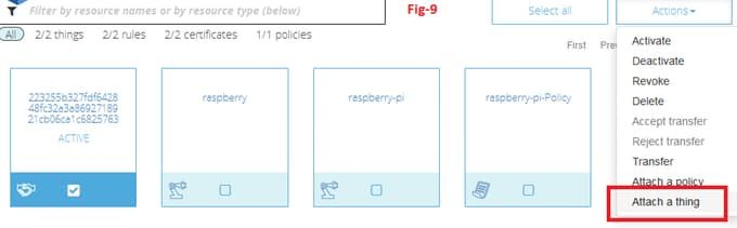

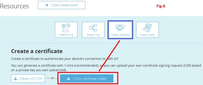

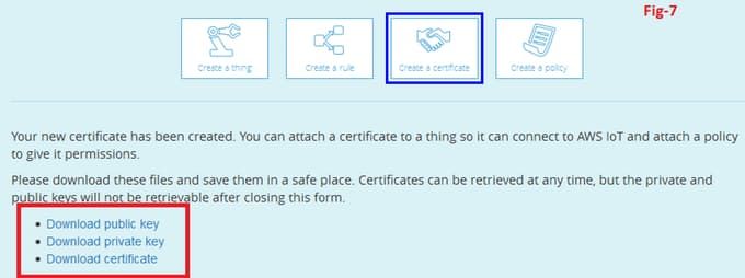

7. Now, click to Create a certificate & then click 1-Click certificate create (Fig-6)
8. Download all the keys & certificates, it will be required for connection with AWS IoT (Fig-7)

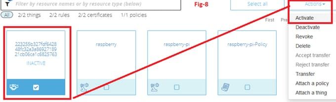

9. To activate already created certificate, select particular certificate and then Activate it from the Actions menu (Fig-8).

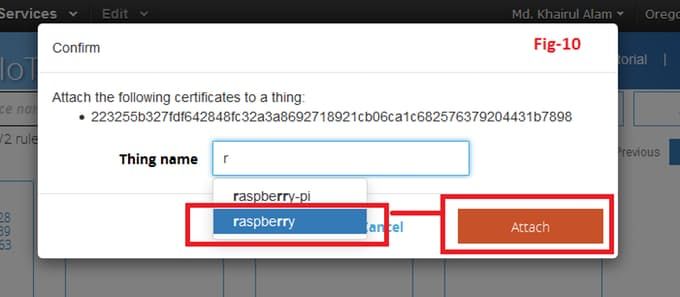

10. Now, you need to attach the thing to the certificate. To do it select the certificate and then Attach a thing from the Actions menu (Fig-9).
11. Type the thing name and click attach (Fig-10).

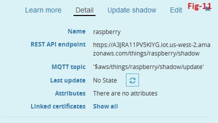

12. You can see details of thing on the right side as in screenshot by clicking on the thing name.
AWS IoT is now ready for our project. Now, it is the time to connect Raspberry Pi to AWS IoT.

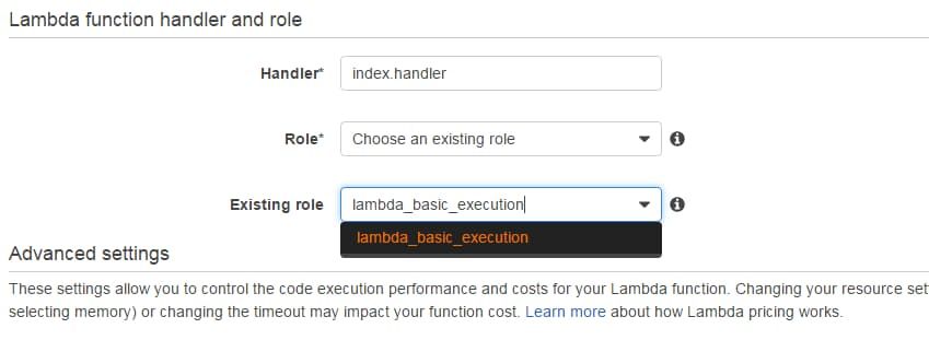

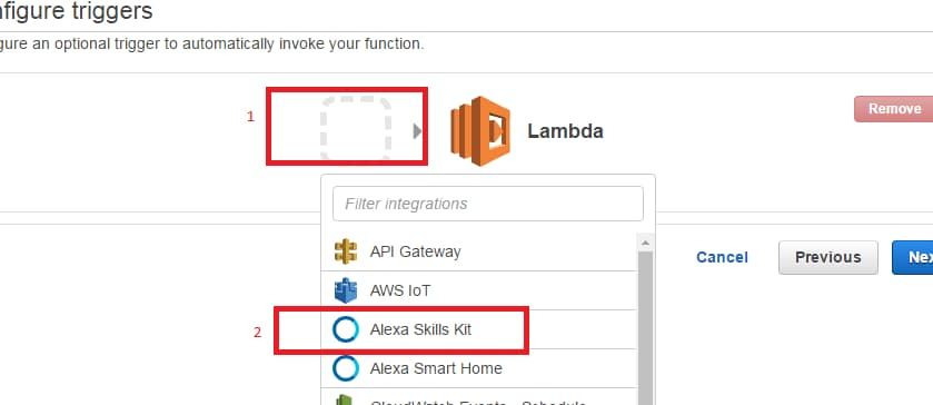

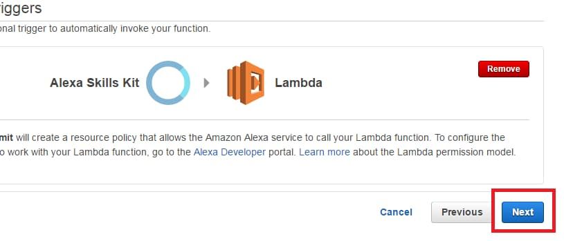

Step 6: Create a Lambda Function

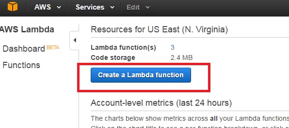

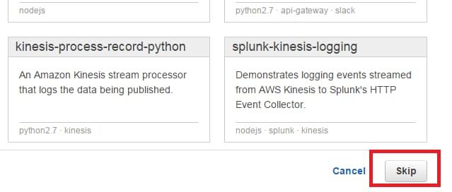

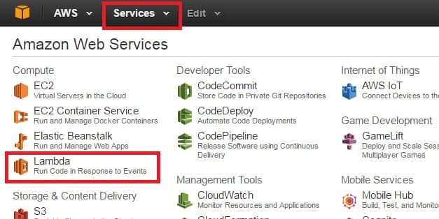

1. Log in to AWS Management Console and from the Service select Lambda.
2. Click to Create a Lambda function.
3. From the bottom right corner click to Skip.
4. Click the rectangle box to choose trigger source and select Alexa Skills Kit.
5. Then click to next.

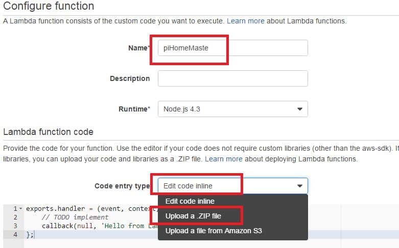

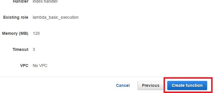

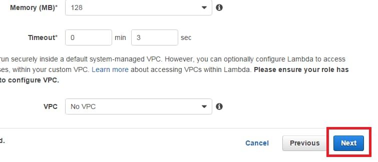

6. Give a name and select Node.js 4.3 as Run time. Description is optional. From Lambda function code section select Upload a .ZIP file for Code entry type dropdown.
7. Upload a dummy zip file to successfully crate the Lambda function. We will upload our final code later.
8. From Lambda function handler and role section choose lambda_basic_execution from Existing role.
9. Then click Next.

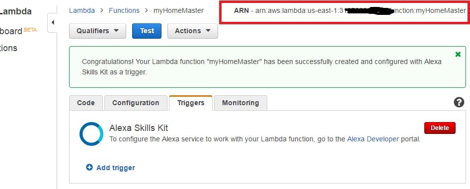

10. Finally click to Create function.
Note the ARN, it will be required later during the creation of Alexa Skill.

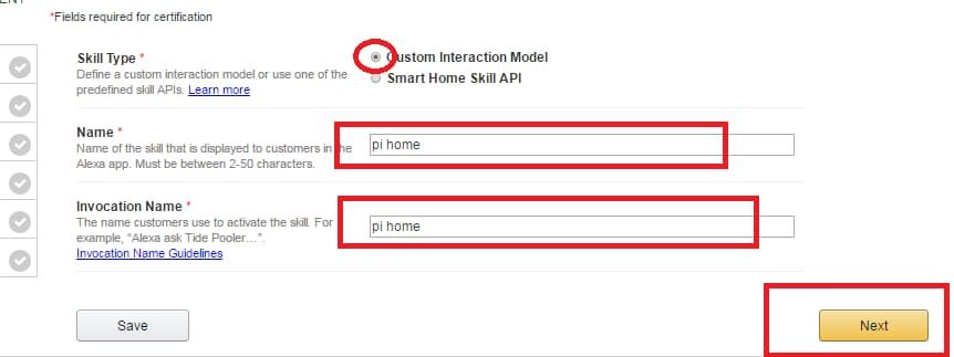

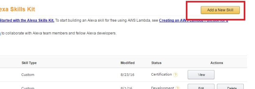

Step 7: Make a Custom Alexa Skill

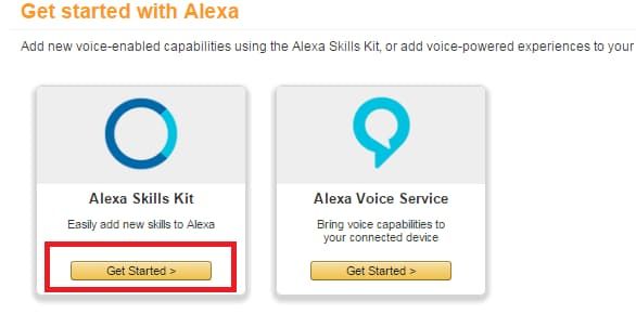

1. From Amazon Developer Console click to Get Started from Alexa Skills Kit.
2. From top-right corner click to Add a New Skill.
3. Select Custom Interaction Model and give a Name and Invocation Name and than click Next.

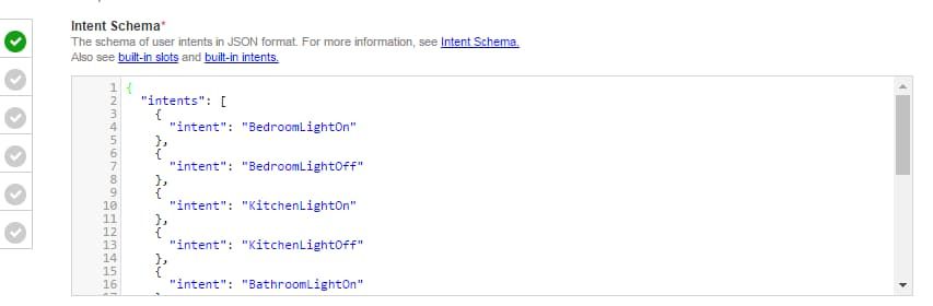

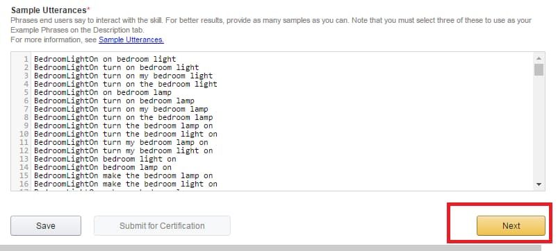

4. From the code section copy the JSON file from Intent Schema and pest it to Intent Schema section.
5. Do the same for the Sample Utterances and click to Next.

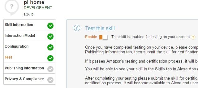

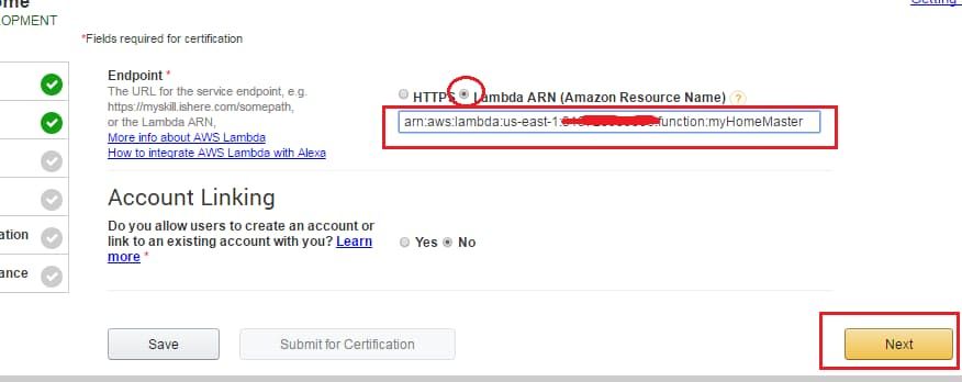

6. Select Lambda ARN as Endpoint and paste the ARN code you got at time of Lambda function creation to the textbox.
You can test your skill from Test tab but as we did not upload lambda code so we will be able to do this after next step.

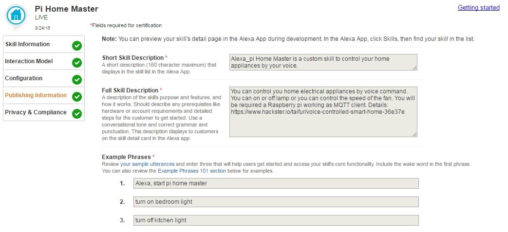

After successfully testing your skill you may submit it for certification. To do that click to Publishing Information and follow the instructions.

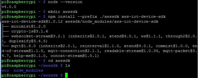

4. Install aws-iot-device-sdk module to the directory using the following command
npm install --prefix ./awssdk aws-iot-device-sdk
After completing go to the directory and use ls command to test either it successfully installed or not. You will see two directory named etc & node_modules .
If you found this then you successfully did the job. Transfer the directory to your PC using FTP client. This module has to be uploaded with lambda code. You may also upload it directly from raspberry pi using VNC.

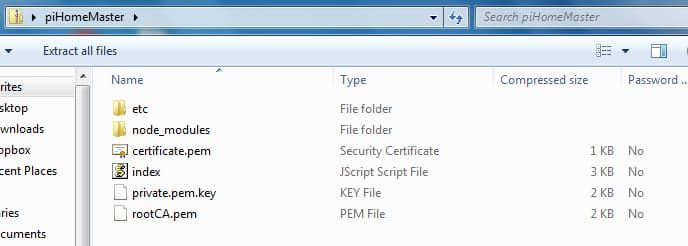

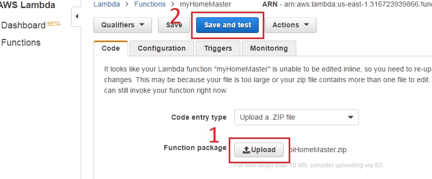

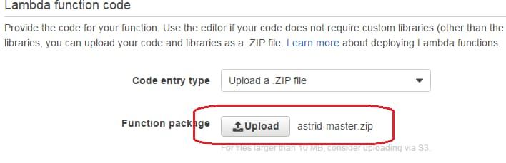

5. Make a zip folder and integrate all certificate files you got from AWS IoT thing creation, node modules you just prepared and the lambda function named index.js.
6. Go to lambda console of AWS Services and upload the zip file as Lambda function package.
