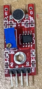

  2. Connecting the microphone to the Arduino
  3. AO pin --> A7
  4. G --> 5v
  5. + --> GND

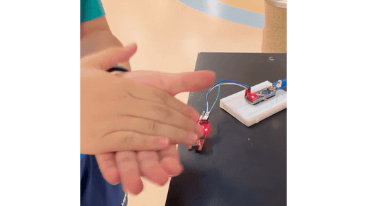

Test of the voice detector can be done in a quiet room. If all the constructions are successful, the light should light up at a certain sound level. I yelled and clapped to the microphone to see if the light could light up.
If there's any problem with any components, refer to the Modifications section below.
A final product is shown here. You can see that every time I clap, the red light is going to shine.

During the construction of this little project, the main problem that appeared was with the microphone. Technically, microphones that can return analog values can be used, as the code in the Arduino requires an analog input to compare the data with the threshold being set.
If there's a problem with the microphone, check for the type (analog) and try to adjust the sensitivity using a screwdriver. If the light is shining even if it's quiet or not shining at all, first check the circuit, and try to adjust the variable VOLUME_THRESHOLD in the code, as it might vary depending on the type of microphone, the sensitivity of the microphone and the surroundings.
