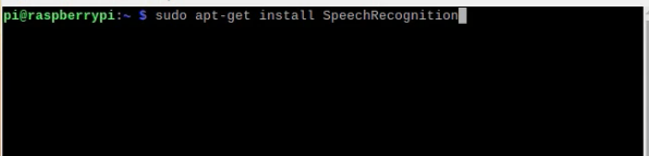

For the raspberry pi we will need to install: pip3 install pyaudio, sudo apt-get install SpeechRecognition, and sudo apt-get install flac
