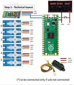

• Use of a 6-servo articulated arm (I'll use the term robot later).
• IR sensor GP2Y0A41SK0F 4-30CM.
• Remote control via Bluetooth (smartphone or another console)
• Rapsberry pico W controller.
• Programming in micropython.

The power supply must be efficient, allowing peak currents of up to 3 amps. The current consumption display allows you to control any drift. For example, if a servomotor jams, the current will rise sharply and the voltage may drop below 4V, resulting in erratic servomotor movement. A visual check of the power supply is therefore essential.
Various remote control units can be used, as shown in the illustration. The DIY model can be built according to the project specifications: https://www.instructables.com/Remote-Controller-for-DIY-Robots/

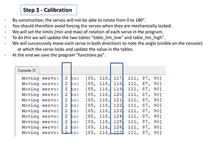

The final step is to calibrate the robot, setting travel limits that must not be exceeded to avoid damaging the servos.
