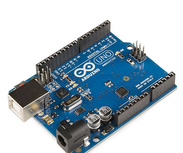

1.Arduino UNO

Step 2: Circuit Assembly!!!!
Well, the circuit assembly is not difficult. The circuit consists only of LEDs, resistors, HC-06 and Arduino. The long "leg" of the LED will be connected to the pinouts while the shorter "led" will be connected to the GND. For the HC-06, the VCC is connected to 5V, GND to GND, RX of HC-06 to Arduino TX, while TX of HC-06 to Arduino RX. From here I will divide the codes into two parts, MIT and Arduino. First let's see the MIT code.

The Arduino code is pretty simple as shown below:
