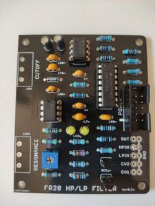

One of my favourite filters is the one Korg developed for the MS20. In particular, I must admit that I have a soft spot for the so called "Mark II" filter because less aggressive than the Korg35 module and more suited to my musical tastes (shame on me).
There are various projects developed around that filter out there, and I had to notice the work of René Schmitz and especially Kassutronics on this regard. In this project, I wanted to keep the filter as similar to the Korg MS20 MKII as possible, using components most resembling those used by Korg and givin up others improvements to it, where possible. I am aware that a subtractive approach is easier than the opposite, so credits goes to Renè and Kassu for their shared work.
The filter here presented clones the original Korg MS20 MK II multimode resonant filter. As per Korg schematics (see the attached extrapolation and edit of the high pass filter part), the active components are LM13600 Dual Operational Transconductance Amplifiers (OTA), some generic amplifiers in buffer configuration at the LM13600 output and a JRC4558 dual op-amp in the feedback circuit. A dual PNP transistor in single package (A798F) serves the main circuit takeing care of the CV tracking.
These components are mostly obsolete, but there are very good replacements availabe. The LM13700 is a direct replacement for 13600 and high performane amps, specifically designed for audio applications like the NE5532 are the obvious choice as buffers in the audio path.
Feedback and especially CV track circuit are less prone to give audio interference, so it is possible to use a more generic (noisy) op amp like TL072. I made some testing and, honestly, could not hear any difference by using NE5532 in place of the TL072.
The A798F in the exponential converter circuit is replaced by two BC557.
I used yellow LEDs to emulate the presence of three diodes and get a voltage drop in the range of 2.1-2.2V. You can use a different color (i.e. green or even blue) if you want a more "wild" behaviour from the feedback loop.

A welcome characteristic of this filter design is the possibility to switch from a high pass mode to a low pass mode simply by changing the input of the incoming audio signal. The Korg MS20 was equipped with a high pass resonant filter followed by a low pass resonant filter (see previous step).
The PCB I have developed takes this into consideration, and the fact that PCB manufacturers give you multiple of 5 PCBs. So, instead of developing a bigger, double LP+HP filter, you can easily populate two PCBs, and set the two to different modes.
High Pass mode can be set by short circuiting to ground the low pass input (LP_IN) and feeding your audio source to high pass input (HP_IN).
Low Pass mode can be set by shorting the high pass input (HP_IN) to ground and input audio to LP_IN.
I placed ground pads all over the PCB: it's your choice to use one pad per jack connector or daisy chain grounds directly on connectors.

Notice that the filter pictured in this instructable is my prototype and doesn't have an inverse polarity protection diode. The version shared actually is voltage protected against +12V and -12V invertion. It's also slightly rearranged in some relative distance between components.
The board is intended to be mounted perpendicular to the front panel. If your case is not deep enought, you can lock the board on the case bottom and use wires to gain electrical connection with elements (potentiometers, buttons, jacks and so on) on the front panel.
