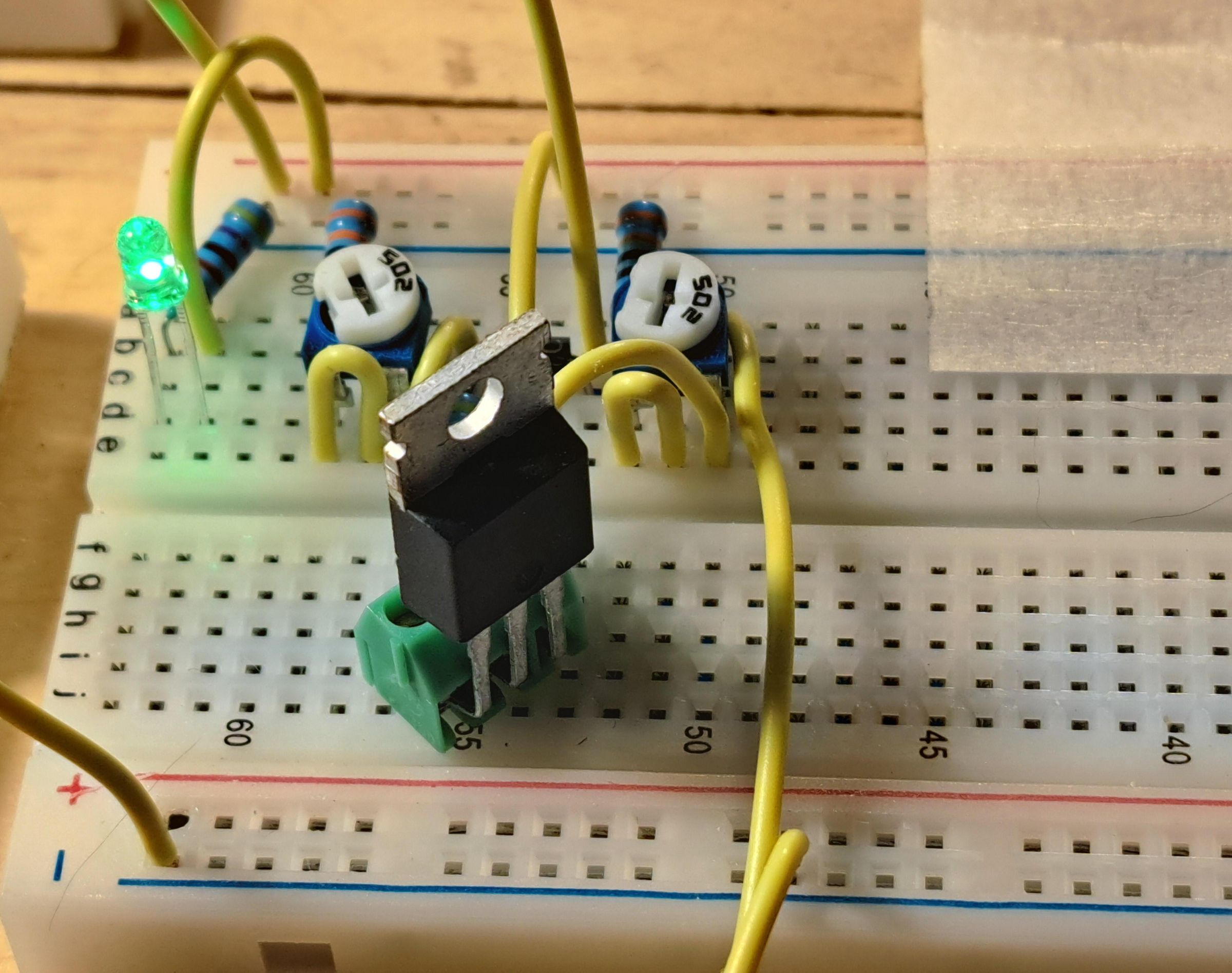

Step 1: Build the Controller Circuit on a Breadboard
The controller components handle very little current, so a standard breadboard works well. The MOSFETs are placed on a separate circuit board that can handle higher currents. There are three connections between the two boards, one for the MOSFET Gate voltage, one for the Drain voltage, and one for the Source voltage.
When the voltage is high on the Drain side of the MOSFET, the voltage at the base of Q2, the PNP BJT. is high, and the PNP BJT is passing no current. This allows the voltage on the Drain side of the MOSFET to open the MOSFET Gate, passing voltage and current to the Source side of the MOSFET.
When the voltage on the Source side of the MOSFET reaches the breakdown voltage of the Zener diode, voltage on the base of Q1, the NPN BJT, is made high, turning on the NPN BJT, which drops the base voltage of the PNP BJT to ground allowing current and voltage to pass through Q2. This, in turn, brings the Gate of the MOSFET to ground, switching off the MOSFET.
And so it cycles. I have measured the oscillation frequency to range between 6.7 kHz and 130 kHz.
I have used the device with a few different loads and it performed well. The voltage remained steady. With this setup using an N-Channel MOSFET as the workhorse and the PNP transistor performing the P-Channel function, that the output voltage of the device is 0.6-0.7 Volts above the rating of the Zener diode. I believe that has to do with the forward bias voltage drop across silicon Zener diodes being ~0.7 V. So when I use a 5.6 V Zener, the output voltage is 6.25 V. In the last photo, I built the voltage controller right into the circuit board where the voltage was needed to run an SN74HCT74N Flip-Flop, which can operate at a maximum of 7.0 V, and the voltage supply rail is at 12.1 V.
