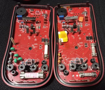

However, as you may have guessed, these ratings, as in every Chinese multimeter, are completely made up. If you look at the first picture of this step, you will see the internals of the German version on the left and the Chinese version on the right. The former features varistors, PTCs, and bigger HRC fuses, which makes the CAT ratings far more believable.
If you look close enough at the first and second pictures, you will notice that both PCBs are exactly the same, giving us the opportunity to install such features ourselves, considerably improving the meter input protection capabilities.
