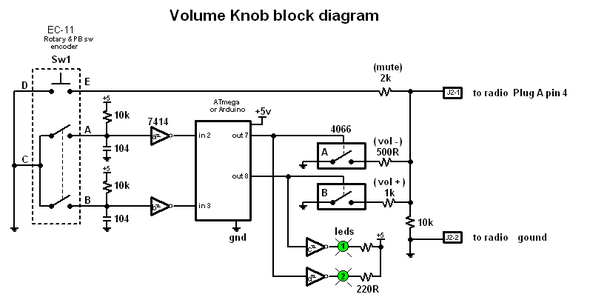

Step 1:
The circuit

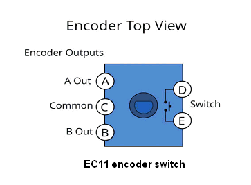

Switch 1 is a 2 channel (mechanical) rotary encoder switch with a centre push button mom, N.O. part # EC-11.
Its outputs are buffered via U2 a SCHMITT trigger # 74HC14 or equivalent .
U2's outputs are fed into i/o pin 2 and 3 on the ATMega (U1) or (an Uno). or equivalent.
U1's Outputs i/o 7, 8 go to U3 the Quad Bi-lateral switch (U3). to control the 2 resistors (R9, R10) that act like steering wheel controls buttons. NOTE the resistor values for R9, R10 can be pretty much anything as the radio will learn that specific value when you do the settings programming on the radio. My R9 R10 values might conflict with yours, if so find a resistor value that works for you by trial and error.
Green leds D1, D2 are activated by 2 gates from the 7414 and i/o 7,8 as well. They light up for each "click" of the encoder switch. Gives you a visual of what the 4066 is doing.

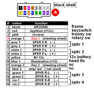

Hooking up to the radio
On the back there is the connector "A", its a 16 pin with free ends or possibly connectorized , locate wires pin 1 and pin 4. It should be labelled "KEY 1" or "KEY 2", pick either one makes no difference.This is the wire that would normally go to the steering wheel buttons. Wire 1 is a ground , this is connected to J2 pin 2 in my circuit and pin 4 (key) goes to J2 pin 1.
If you are keeping your steering wheel buttons in play, as mentioned before my resistor values might conflict with your values. I would suggest you find your Vol+,- buttons resistor values for your specific car and match them to my circuit R9, R10.
This project acts like a remote relay pressing the Vol + and - on the steering wheel.

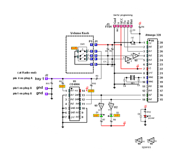

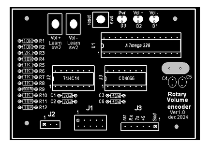

My prototype PCB overlay is a laser printed page stuck to a blank board, drilled and mounted the components. Some might notice more parts than I describe / use in the schematic, this is because i had other features that im not using here. Such as secondary PB buttons and a reset sw.
