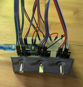

Today I would like to introduce you to the "deej" project from omriharel (GitHub). This enables volume control via external hardware and not only control of the overall volume, but also individual programs or devices such as speakers, headphones or the connected microphone on your PC.
For example, the volume of individual programs can be mixed independently.

Connect the rotary encoders as follows to the Nano.
The number of rotary encoders can be varied as required. Three are used for illustration purposes.

Finally, you can print a bracket with a 3D printer to test the encoders in conjunction with the breadboard. This is a simple holder that can be printed quickly and attached to the breadboard. You are welcome to adapt the model in a CAD program according to your ideas.
Printable .stl file
Customizable .step file
Step 4: Conclusion
Now you can use three rotary encoders to change the overall volume, the volume of Spotify and the volume of the program you are currently using. You can also add more rotary encoders to control more programs or devices individually.
