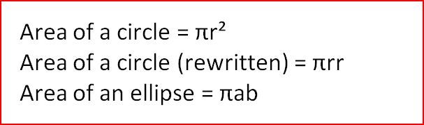

Look at the formula for calculating the area of a circle below. Since we know that squaring a number means multiplying it by itself, we could rewrite the formula as pi x r x r. As it turns out, calculating the area of a circle is a special case of calculating the area of a squashed circle, known technically as an ellipse. An ellipse has two measurements, one vertically oriented through the center of the ellipse called the minor axis (to calculate the area we need 1/2 of the minor axis length, which we'll call a), and one through the center on the long axis of the ellipse called the major axis (let's call half the length of the major axis b). To calculate the area of an ellipse, the formula is pi x a x b. Multiply the area of the ellipse by the height, and you have the volume of a tube with an elliptical cross section.
Thus, if you can measure the area of the end of tube or bar, you can measure the volume once you have the length.
