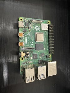

Raspberry Pi 4

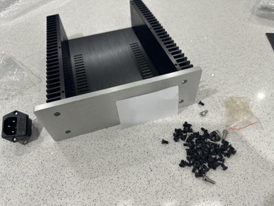

Super-sweet case!!

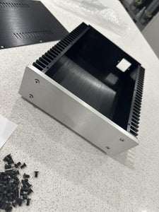

Douk Audio Aluminum Chassis HiFi Case Amplifier Enclosure DAC Cabinet DIY Box_UK
https://www.amazon.co.uk/Aluminum-Chassis-Amplifier-Enclosure-Cabinet/dp/B073WVQTJ8
Worth shopping around for these cases on Bangood/Ali etc. the price varies wildly. I must say I was very happy with the quality of this one. Really chunky and even the bottom plate was thick enough to tap to mount the Raspberry P. I thin you'd probably spend more money on aluminium plate if you were buying it separately.

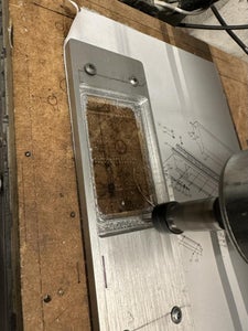

Step 1: Cut Out the Case

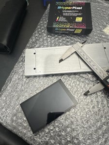

Ok this step is self-explanatory. I accept I cheated by using a AliExpress CNC Router here but I have uploaded all my measurements here if you want to print a template and get going with a Dremel/other rotary tool. If you are going the CNC route I have included my Fusion360 file so you could go in there and build a toolpath yourself.
Thinking about this some more, if I were doing this without a CNC router, I would cut a hole using an electric jigsaw as neatly as I could and then 3dPrint a nice bezel to go in the hole to neaten up and cover any imperfections. This might make it easier to mount the screen too.
I mounted the faceplate to the spoilboard directly and the cut was really nice from the front as you can see with only minor deburring needed. The router took FOREVER to get through that 8MM aluminium!

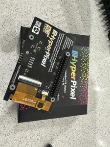

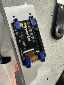

Step 2: Mount the Touchscreen
Nothing fancy here, the screen fitted into the recess beautifully! All i needed to do was drill 4 holes with the 2.5mm drill and tap to 3mm. Make sure the holes are as close to the screen recess as possible as there isn't a lot of space between that and the side of the case when assembled.

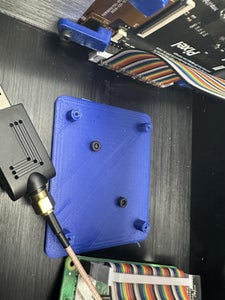

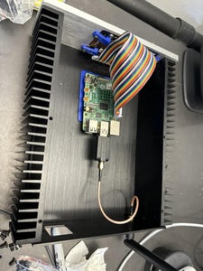

Step 3: Mount the Pi and Fit Everything Into the Case

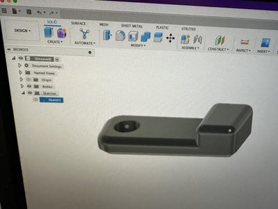

Again pretty simple. I mounted the pi on a 3dPrinted base as shown. I have included the Fusion F3d if you want to print it yourself. This was a good opportunity to stick a heatsink onto the CPU too. The case is nice and airy so shouldn't be a problem but better to do anyway.
Connecting up the screen with the Ribbon cable was a bit of hassle as I needed to butcher the plastic shroud off one end of the cable for it to fit into the display. I used a dremel for this but a pair of pliers or hacksaw would work just as well.
