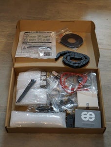

Once the package was shipped, it arrived within just one week in germany. A few small dents in the cardboard, but overall everything seems in tact.
Everything inside is packed quite, well nothing is flying around. I attached a bunch of pictures so you can see for yourself.
  • the parts arrived in a bunch of small boxes and bags.
  • small items like the screws are also labeled so you can easily find the right ones
  • the power supply looks like a genuine meanwell power supply to me
  • the linear rails have Hiwin engraved on them - but I'm not sure if that's a reliable way to verify their authenticity :D
  • the bed looks really nice with the black coating, but I have no idea if it's actually Mic6.
  • the heating pad seems to be a noname product (not from keenovo) but they also never claimed that
  • the aluminum extrusions seem to have all the holes predilled and tapped
  • the PCB for the small OLED screen has some flux residue on it, but this can easily be cleaned
  • the segments of the cable chain can not be opened, but I am not sure if there even are such small cable chains that can be opened?
  • the panel parts are wrapped together and still have their protective film on them - I will check later if there are any scratches
