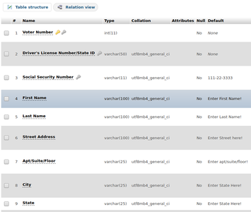

A voter registration database designed for counties with smaller populations. Created using MX Linux, Firefox, MariaDB, Apache2, PHP and phpMyAdmin.
Files include SQL (change extension to ".sql"), OpenDocument Spreadsheet (change extension to ".ods"), CodeGen (change extension to ".cs), HTML (change extension to ".html"), Texty, Word, OpenDocument Text, Excel, and CSV (comma separated value).
The final field will allow the database administrator to upload a picture of the voter's signature. This field will only work when importing the SQL file into phpMyAdmin since it is a Blob type. If using this field, please be sure that the picture is less than 64 KB. An easy way to get a picture this size is to reduce the resolution of the smartphone camera to 800x600 and then tightly crop the final picture.
The SQL file is below and attached.
