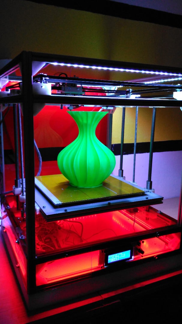

The Vulcanus Max 30 has a 32x32x32 build volume, E3D V6 lite extruder, auto bed leveling and MK8 Direct Drive system.
The Vulcanus Max 40 has a 42x42x42 build volume, E3D V6 lite extruder, auto bed leveling and MK8 Direct Drive system.
In summary, Vulcanus Max is a scaled up version of Vulcanus V1 with structural upgrades, all metal direct drive, auto-bed leveling, LM10UU bearings and LMK12L Z bearings and colorful lava like acrylic panels.

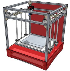

A RepRap 3D printer is always open design so please feel free to download the sketchup file. All dimensions are in 1 to 1 scale.
There are 2 versions we have tested, and are working 100%. Vulcanus MAX 30 and Vulcanus MAX 40, we are still working on the Vulcanus MEGA MAX (52x52x150) so keep tuned in.
Use the sketchup for dimensions, and the Vulcanus V1 instructions to guide your way through the build process.

Start off by , opening the 3D sketchup in the previous step. There you can find all dimensions from smooth rods, aluminum profiles, and acrylic panels. Use the sketch as much as possible to obtain all relevant information.
The build process is the same as V1, using materials and parts from V MAX.

Vulcanus Max 30 and 40 are upscale from Vulcanus V1 3D printer, so most of the parts are different:
- Z smooth rods are 12mm instead of 8mm (for rigidity).
- XY smooth rods are 10mm instead of 8mm (for rigidity).
- XY bearings are LM10UU instead of LM8UU.
- Z bearings are LMK12L instead of LM8UU.
- Extruder is MK8 Direct Drive instead of original Vulcanus V1 extruder.
- All parts where redesigned to allow bigger bearings and bigger rods, with the exception of the corners and the Z motor holders.
- The aluminum print plate is 5mm thick.
- Red acrylic panels instead of metal ones.
- LED strip on top and in the bottom of the second base.
- The V MAX's use inductive sensors for autobed leveling.
- Using repetier firmware instead of Marlin firmware (because i am more used to repetier).
