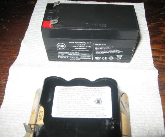

by the way. i have a small 12V mini sealed lead-acid battery from another my project which allowed me to check how it works before installing it back. you will also need two hoses and a bucket.
