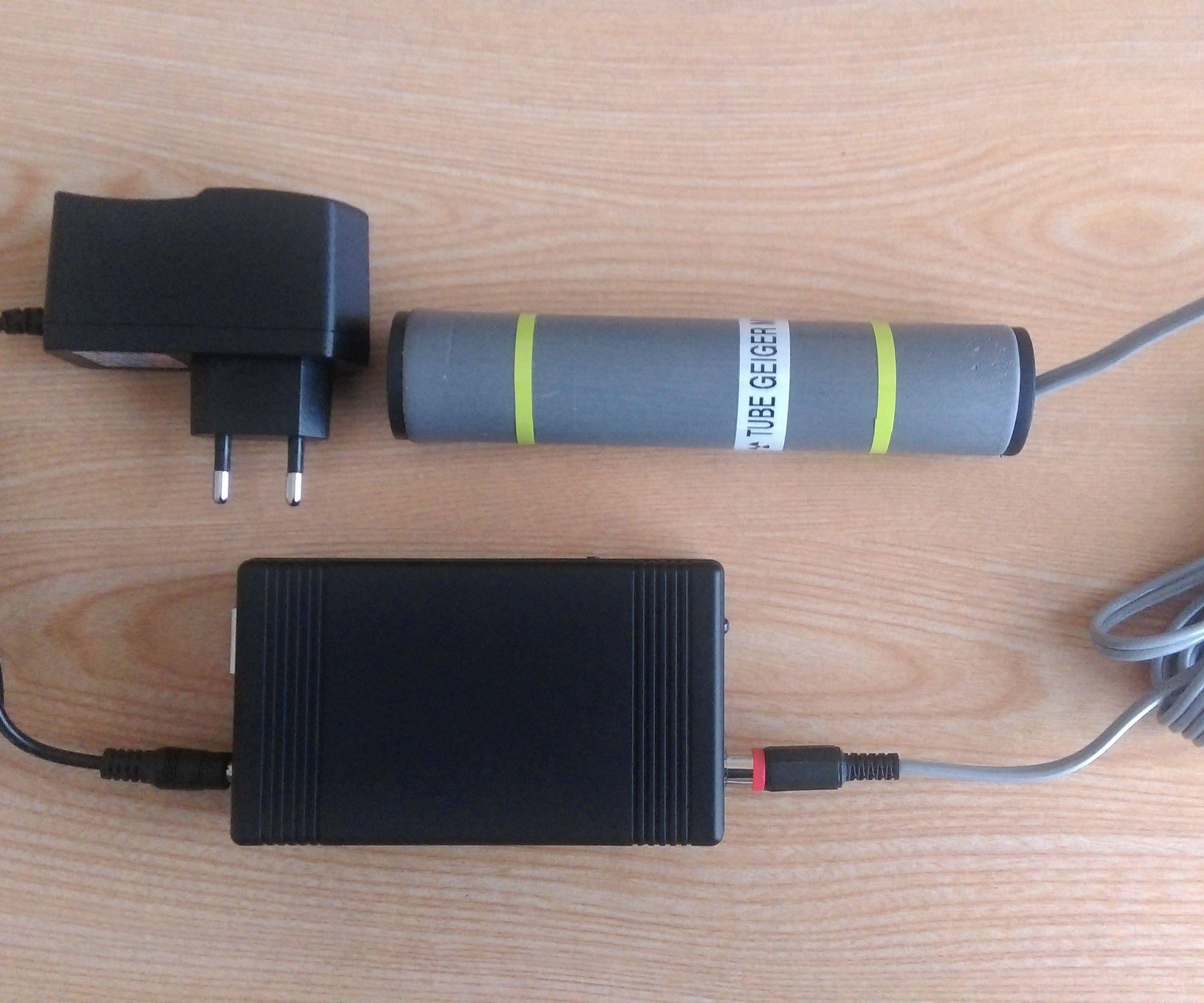

The W-GM Counter based on an ESP32 chipset (Heltec WIFI kit-32 with OLED) is a fork of the Ethernet C-GM Counter and costs (27$/22€) about half price of the C-GM Counter.
This D.I.Y low cost radioactivity counter project provides hardware and firmware for building a Geiger-Müller counter device aka G.M. counter for continuous measurement of the radioactivity level. It is uses an ESP-32 with OLED, a booster module inside the 400V power supply, a battery charging circuit and very few components around.
Our design has been drastically optimized to reduce as much as possible to the minimum number of components and enable users to wire the hardware on a piece of Veroboard without requiring specific material.
The W-GM Counter is able to run as a standalone radioactivity counter or for ensuring long term radioactivity monitoring, can be used in association with A-GM Manager (see the Eco-System) that is an open-source web application running on a SOHO server (e.g. QNAP sells Small Office Home Office servers). A-GM Manager is also able to publish the W-GM Counter measures on the worldwide shared map managed by GMC MAP. Finally, there is also a Node-RED version for integration of the W-GM Counter with Node-RED such as the QNAP IoT framework.

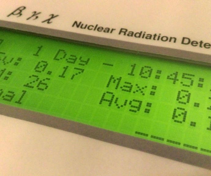

The W-GM Counter device counts the number of radiation pulses (CPM) over a one minute period (shifting window), and convert this count into a micro Sievert per hour (µSv/h) value using the G.M. tube conversion factor.
  • At start-up, the splash screen displays the version and copyrights of the C-GM counter device firmware.
  • About 5 seconds after the power-up, the splash screen closes and the counter starts the radiation measurement.
