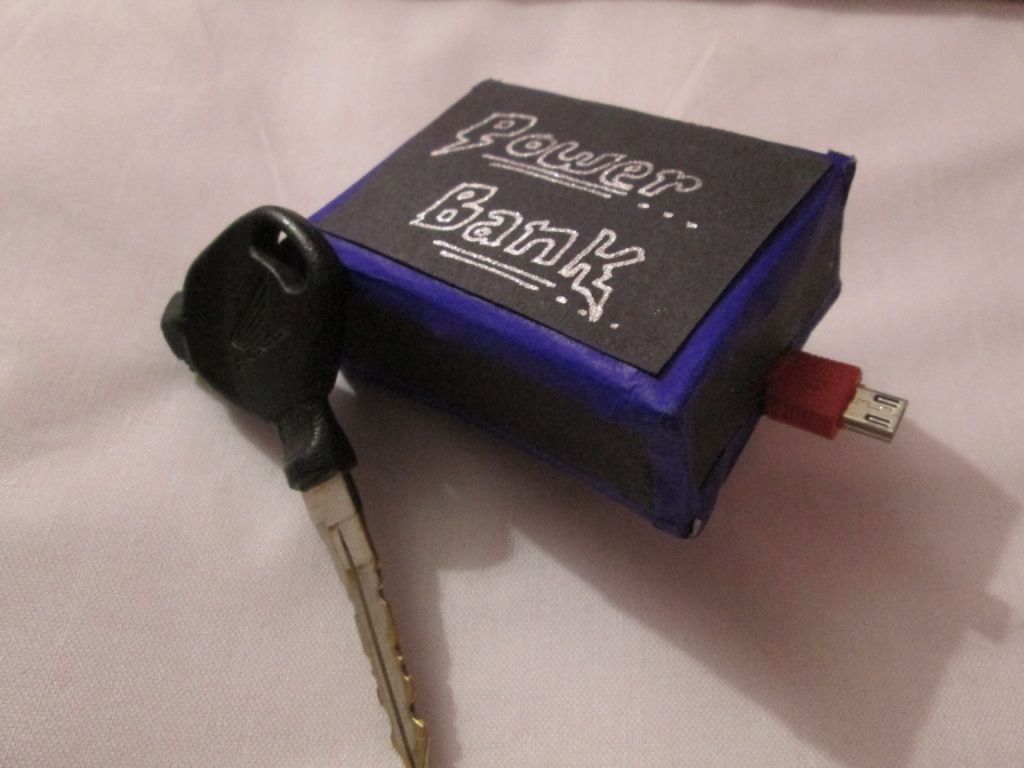

Step 11: Making of Power Bank
For making a power bank , firstly connect the positive output point of lithium charger to the positive terminal of battery and further connect that wire to the input (positive) point of step up convertor(5v)
And now vice versa with the negative point.
Note- As you can see i have used mobile battery instead of cylindrical battery (both are same thing of 3.7v)
and I have used double sided board in place of to boards (it is better, it occupies lesser space)
Step 12: Connecting Power Bank to D.C Generator
The output and ground points of D.C generator would be now connected to the input points of lithium charger.
And taped it well....
Step 13: Final Setup
Connect the positive points of U.S.B port to the (+) output end of step up convertor and negative end of U.S.B port
would be firstly connected to switch,then further connect the same with the output (-) point of step up convertor......
