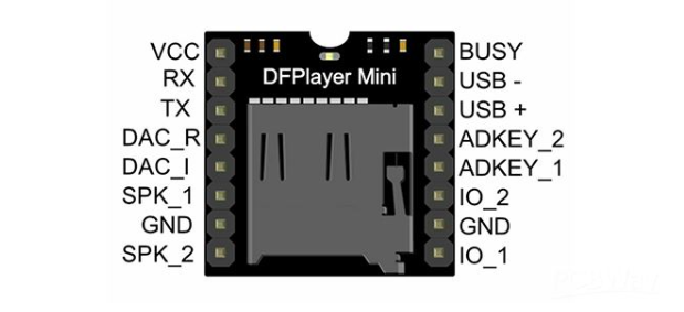

The star of this project is the DFPlayer Mini, which is a mini MP3 Player Module that is based around a 24-bit DAC IC along with an onboard SD Card reader that fully supports the FAT16 and FAT32 file systems.
This module supports a variety of control modes, I/O control mode, serial mode, AD button control mode, etc., meaning the user can use this board as a standalone device or use an external microcontroller to drive the module.
We could have used the barebone setup, which only requires push buttons to be added to a few of the module's I/O pins,, if our application was limited to playing tracks and shuffles. However, we needed a display with a proper menu that allowed us to select songs, so we used a Pico and paired its TX and RX pins with the TX and TX pins of the module.
We use Pico in conjunction with the DF player; Pico uses the TX and RX pins to operate the DF Player, and the OLED displays the music details and menu.
For more info about this module, you can checkout its product wiki published by DFROBOT.

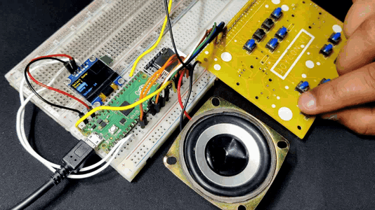

  1. First, we combined the Pico, DFPlayer, Buttons, OLED, and Speaker by joining them all together according to the wiring diagram.
  2. We connect the OLED to the Pico by connecting its VCC to VBUS, GND to GND, SDA to GPIO4, and SCL to GPIO5.
  3. Next, we paired the DFPlayer with the Pico by connecting the VCC of DFPlayer with the VBUS of Pico, GND to GND, the RX of DFPlayer will be connected to GPIO7, which is the TX of PICO, and the TX of DFPlayer will be connected to GPIO8, which is the RX of PICO.
  4. Speaker's positive is connected with DFPlayer's Speaker 1 port, and negative is connected with Speaker 2 port.
  5. We utilized a test board created for projects like this one, where we have to put together a setup on a breadboard, and it had a lot of buttons, so we used it for the buttons.
  6. The GND ports on each button are linked to one another and will be connected to PICO's GND. GPIO10 is connected to the Next button, GPIO11 to the Previous button, GPIO12 to the Select button, GPIO13 to GPIO14 to the Volume up and Volume down buttons, respectively.

This extremely basic build culminated in a working audio player that can play music that is stored on the SD card. We can select the song we wish to listen to and control the volume with buttons.
Three songs that we added to the SD card, are read by the DFPlayer and output through a 3 Ohms 5W speaker.
The speaker in this instance is being powered straight from the DFPlayer; an audio amplifier can be connected to the output of the DFPlayer if we wish for creating a louder setup.
