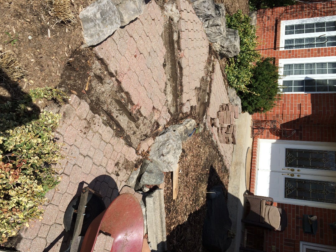

Step 2: Tearing Out the Existing
Now that you have a design that you like you can begin tearing out the existing material. If you are building a new walkway or patio this stage would be the "excavation stage"

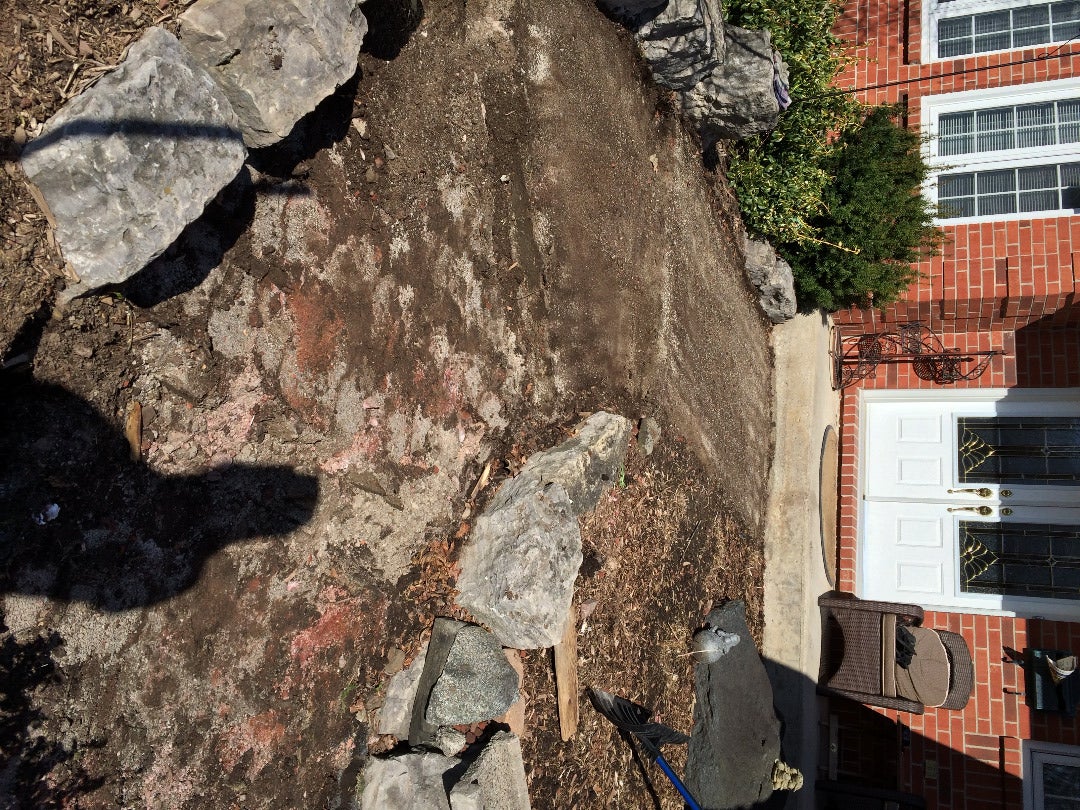

For this project I was sure not to contaminate the base with the soil that had fallen between the existing paving stones because I am planning on using the base material for my new walkway.

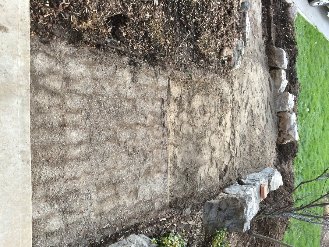

Step 3: Clean Up for Construction.
For this project I used the existing rocks on site and moved them to accommodate the new design.
I raked out the base material and removed all soil from the original paving stone.
I began to dig out where the first step would have to go to get an idea of what it will look like when complete.

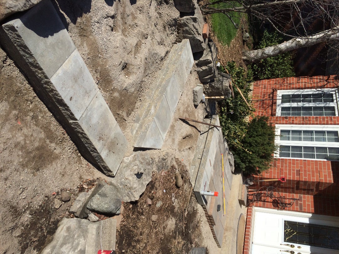

Heights
For the steps the first thing is to set your heights. From my driveway to the porch the height is 29" so I know I need 3 steps with rise of 7" per step and then 1 step onto the porch. (4 steps total)
Start with the lowest step and work to the highest step
I set a line level 7" above my driveway then ran a string line to the front of the step to get the height of the top of the 1st step. I know that with this step material 1 full step from bottom base stone to top of cap is 11" so I have to remove the base material 11"-12" below my line level. once I have removed base to the correct depth I use the hand tamper and compact down the base where the step will sit to improve the strength of the step. Then I use some screenings and just with my hand add about 1/2" to the compacted base. the screenings will help you level your stone base.
Leveling
Get the base as level as you can by eye then place your first step stone. I use a small level and check the side to side and back to front levelness I always keep the back of the stone slightly high because this will allow water to run off the step and not pool at the back of the step. Which ever side is off level use the dead headed mallet to pound down and make level. After I lay 1 stone check it with your line level to make sure your heights are still correct.
Repeat this process with each stone until you have a bottom layer of the step that is completely level right to left and leaning slightly forward back to front.
Then begin to build your step. Make sure to stagger your joints for the step stone. This looks better as well as provides structural support for the step. finally add your cap stone and repeat process for how ever many steps your have.

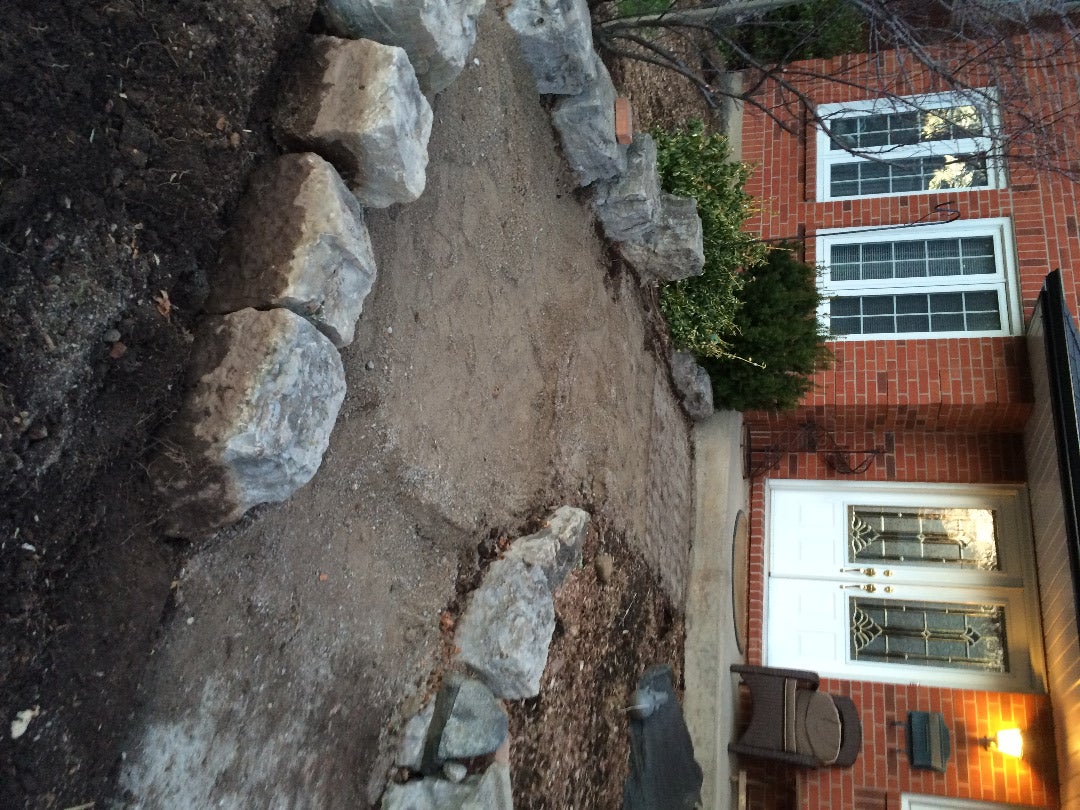

Step 5: Preping for Pavers

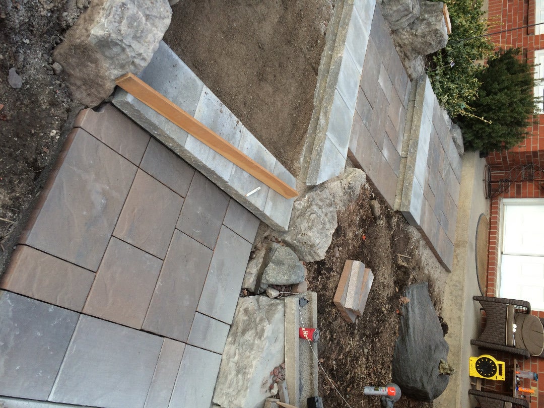

Now that the steps are complete you must prep the base to lay the paving material. I know that the paving stone I chose is 2-1/4" thick so If I want it to sit flush to my top of step I need to have a base that's compacted to the perfect slope and levelness 2" below my top of step. the extra 1/4" will be compacted down after.
To achieve this I rake the base adding or removing material by eye to 3-1/4" below the top of the step. Then using the 1" bars I lay them in place and add screenings to the ground to set the pipes at the exact height I need.
I start by making sure 1 end of the pipe in exactly 2" down from the top of step then I level the pipe with a slight slope away from my house for drainage. then repeat the process for the second pipe.
After both pipes are level and have the slope you want place the level on both pipes making sure the slope is correct. now that both pipes are set and at the correct height add more screenings to the area almost covering the pipes.
Use a 4' level and drag the level across the pipes pulling the screenings with you creating a perfectly level area. once complete remove the pipes and carefully fill the gaps with more screenings.
repeat this for all landings
*** if you are laying a patio using 10' pipes is helpful because you can do more are one time***

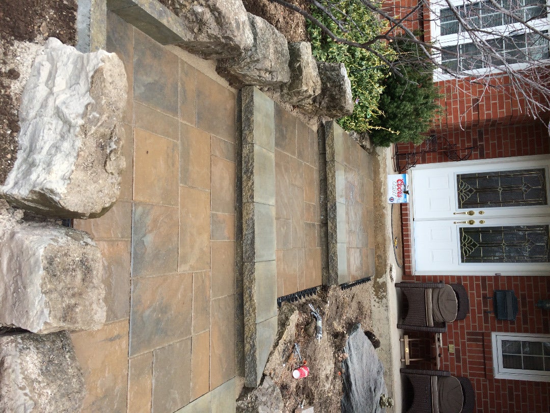

Step 6: Laying the Pavers
I started with the upper landing closest to my porch and I used the porch to lay off of because I wanted the walkway square to the porch.
Laying
Paint out a general guide line for laying and begin placing your pavers. Be sure not to step on the screening base you just prepped in the last step. The pavers need to be placed evenly on the ground and the screenings should be level with a slight slope away from the house.
Lines

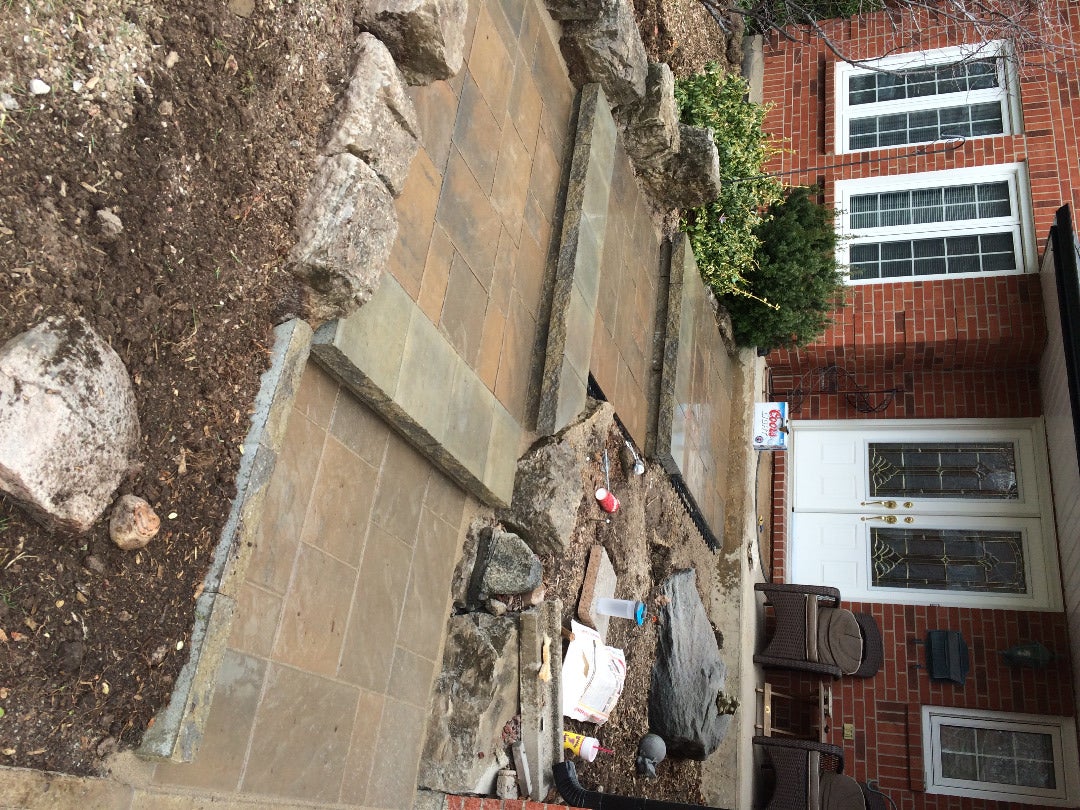

Follow any pattern you like or lay just randomly but try to avoid the + sign or cross hair look, always stagger where joints hit.
Repeat this process for the rest of your landings or patio.

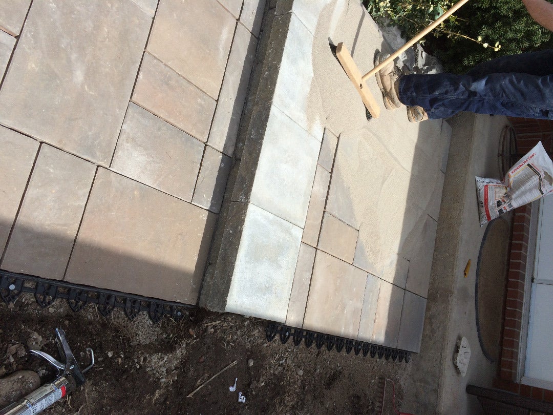

Step 7: Sanding
If you are using an edge material secure it into place now.
Using polymeric sand sweep the sand into the joints of the pavers. do this once then repeat as the sand will sink into the cracks and need to be topped up.
***Wear a mask when sweeping***
the poly sand hardens with water and you do not want to breath it in.
After all joints are filled and the remaining sand is swept off the interlock use a hose and spray down the walkway lightly removing any dirt and saw dust then allow to dry setting the sand.

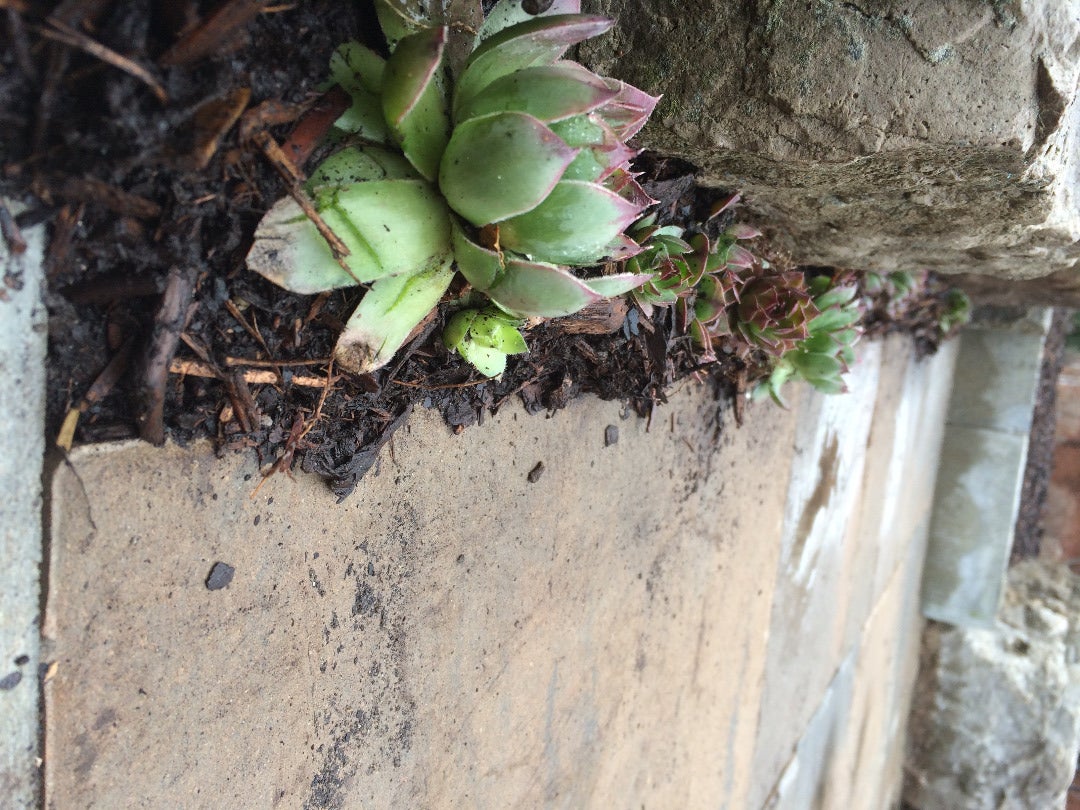

I had saved a few hens and chicks and added them into a small strip of soil in the second landing.
This project was done in spring and the existing plants have not yet grown in so it looks a little bare but there are a number of perennials that will grow in.
