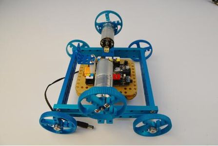

Step 2: Assemble Rectangle Frame
Step 3: Assemble Wheels
Part list:
1x Timing Pulley 90T
2x Flange Bearing 4x8x3mm
1x Shaft Collar 4mm
1x Threaded Shaft 4x39mm
1x Headless Set Screw M3x5
3x Plastic Ring 4x7x2mm
Step 4: Install Orion Board and Battery Holder
Step 5: Install Orion Board and Battery Holder
Part list:
2x Base Bracket B
1x Me Orion
1x Battery Holder for (6) AA
1x Bracket 3x3
2x Nylon Stud M4x30
2x Screw M4x22
8x Screw M4x8
6x Nut M4
Step 6: Replace.
Replace.Nylon Stud M4x30 with Brass Stud M4x32(included in the Hardware Robot Pack) as shown in the following picture
Step 7: Install DC Motors
Part list:
1x DC Motor-25 (185RPM)
1x DC Motor-25 Bracket
1x Shaft Connector 4mm
4x Screw M4x14
2x Screw M3x8
2x Headless Set Screw M3x5
2x Nut M4
Step 8: Follow the Same Steps to Install Another DC Motor.
