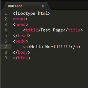

If there is no file in the folder, create an index.php file.
For tutorial purposes, write the following lines of code below to see "Hello World" upon execution

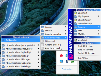

Step 6:
Click on Apache --> Alias directories --> + Add an alias

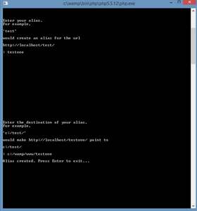

Step 7:
Follow directions on the command screen

Type in the server url into the box that pops up.
This url was created in Step 7. For example, for the example above, it is http://localhost/testone
