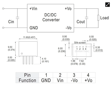

Now the first schematic is the amp it self, but to power the Bluetooth module, use the second schematic where the 5v voltage regulator would connect to the Vin and Gnd pins of the converter and +vo and -vo connect to the Bluetooth module.

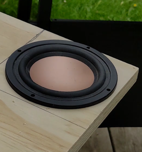

Now the most challenging part, the woodworking job. I used 3/4 inch plywood but I suggest 1/2 inch. I started with a big hole in the center then jigsawed the thing till the speaker fit nice. A big problem I had was the hole I cut was too big for me to create a proper curve with the jigsaw, so I suggest drilling a smaller hole where your jigsaw blade can just fit.
