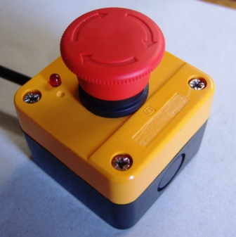

As i whanted to keep this demo online for some time a hits counter would be nice. Therefore i created a variable that is increased every time the "print_builddate" routine is called ( on page loads). Its value is self refreshed by the ajax script. Its a 32bit unsigned integer, it will not overflow ( hehe 2^32 = 4.294.967.296 hits).
If all goes well ( my ISP doesn't block me) you should be able to open my WEBSD board on the address ( it might be slow , as i don't have a good internet connection):
Putting this online was a little hard. I have a domestic ADSL connection, which means no static ip address, and to get things worst my IPS blocks port 80 and 8080 ( common ports for HTTP servers) .
The solution was to use no-ip redirection from port 80, dynamic ip (no-ip and my router) , and redirection again to the 80 port on the ip-add of the board in my local network. port 80 in my internal network so i can access it directly.
