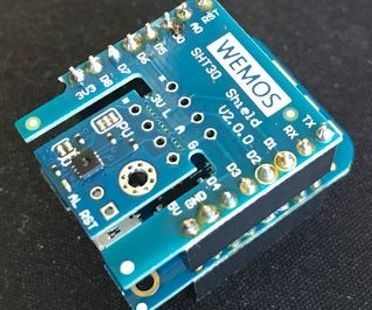

WEMOS D1 Mini Banggood.com product link
WEMOS SHT30 sensor shield Banggood.com product link
USB micro cable
Soldering iron & solder (for the more permanent item) or jumpers for the boards and maybe a breadboard.
Given the components don't come assembled, soldering them is recommend to make life easier.
With the pins on the devices, have the male pins on top and female pins on the bottom of the board. Then the main processor is more usable for your developments later and the shields can be swapped to suit.
Step 2: Once Assembled Into the Two Components
Once you have assembled the two devices with their pin configurations, plug them together.
Making note of the pin alignment. They should fit together with no hassles.

  • I've added in an extra variable to account for the heat generated by the D1 as well as the corresponding impact on humidity. I'm was initially finding about 3.5-4.5 deg C fluctuation against other temperature devices.
  • You can tinker, or to fix it, provide sufficient distance from the processor with wires for either the whole board or carefully snap off the sensor and extend with wires from there to improve accuracy.
  • After a day of side by side testing with the unit as assembled here and another alongside that has extended wires to distance the processor, the temperature fluctuation measured with the Blynk recording on 160 data points is a minimum of 1.212 deg C difference, 2.093 deg C difference, and an average of 1.75 deg C difference. The bulk and the Pareto line on the data is at or around the average of 1.75 deg C.
  • I also found a similar thing with the humidity with this being recorded at 6.115% below the real humidity. And I have added a variable for this too.
  • For my purposes, these quick and dirty manipulations are sufficient for my needs as a degree either way acceptable.
