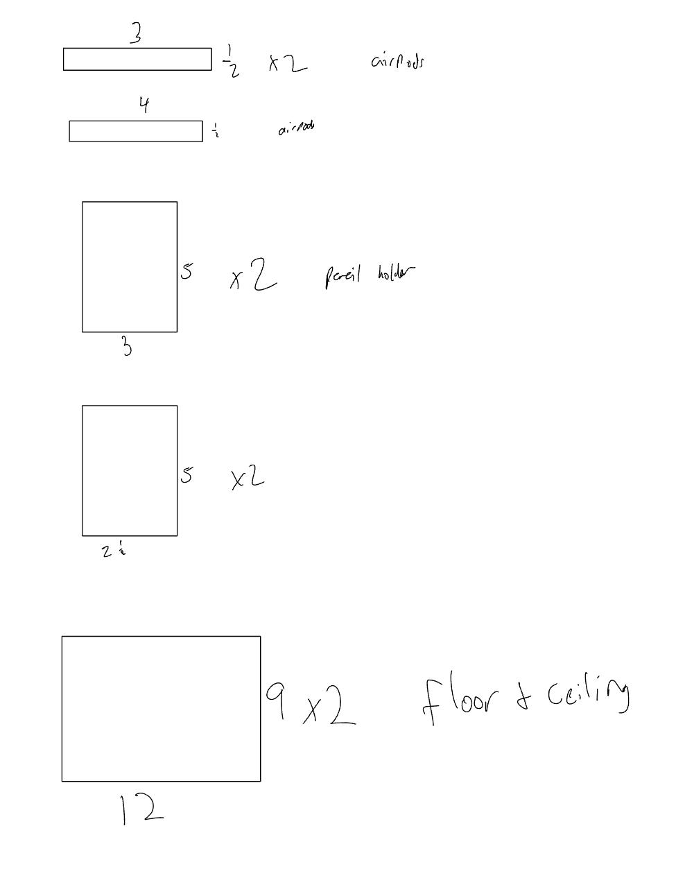

Step 1: Cut
Measure, mark, and cut the wood according to the cut list (pictured). All measurements are in inches and all wood is quarter-inch ply. Pay attention to kerf when you cut to ensure that all final pieces are the required size. Use a table saw for the big pieces and a scroll saw for smaller, more detailed cuts. In addition to the wood cuts, you will also need to cut the felt into a 9x3 and a 9x2.75 in rectangle.
