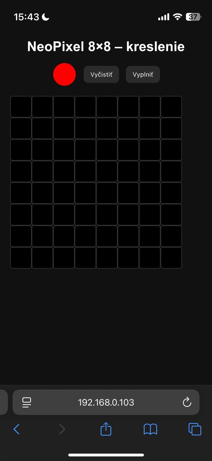

Step 5: CONECTING TO PHONE
in Serial Monitor will display something like: IP: 123.456.7.890
Open this number (IP address) on a device connected to the same Wi-Fi network.
(RED wheel is collor picker) ("Vyčistiť" is clean) (Vyplniť is Color the entire)
