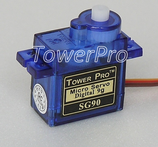

Servo x1: https://www.towerpro.com.tw/product/sg90-7/

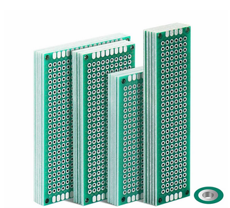

Pcb Prototype Board x1: https://www.aliexpress.com/item/1005004482992911.html?spm=a2g0o.productlist.main.7.2bf52f1fohxURk&algo_pvid=c758abe6-24fe-4e8b-a29c-312e2616baa1&aem_p4p_detail=202302200921394082779875854790001987735&algo_exp_id=c758abe6-24fe-4e8b-a29c-312e2616baa1-3&pdp_ext_f=%7B%22sku_id%22%3A%2212000029319158672%22%7D&pdp_npi=3%40dis%21EUR%218.58%218.06%21%21%21%21%21%4021224cdb16769136992341075d0723%2112000029319158672%21sea%21NO%212160084717&curPageLogUid=gfN4X8WaSXEX&ad_pvid=202302200921394082779875854790001987735_4&ad_pvid=202302200921394082779875854790001987735_4

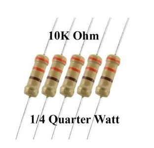

10k Resistor x5: https://www.aliexpress.com/item/1005003021542565.html?spm=a2g0o.productlist.main.7.446b3579XkyOlh&algo_pvid=5ebc1105-e4e8-4078-a878-af3705441e83&aem_p4p_detail=2023022009233310250572079625360002121646&algo_exp_id=5ebc1105-e4e8-4078-a878-af3705441e83-3&pdp_ext_f=%7B%22sku_id%22%3A%2212000023277083848%22%7D&pdp_npi=3%40dis%21EUR%213.8%211.9%21%21%21%21%21%402122457116769138135078589d072d%2112000023277083848%21sea%21NO%212160084717&curPageLogUid=EzIp7WByv2Yw&ad_pvid=2023022009233310250572079625360002121646_4&ad_pvid=2023022009233310250572079625360002121646_4

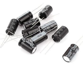

Electrolytic Capacitor, 1x 10uf, 1x 100uf: https://www.aliexpress.com/item/1005002075527957.html?spm=a2g0o.productlist.main.3.13d72ee7BB7Nlx&algo_pvid=3d2d1a33-acdd-4074-8261-e010b587959d&aem_p4p_detail=202302200925372620322909657180013901410&algo_exp_id=3d2d1a33-acdd-4074-8261-e010b587959d-1&pdp_ext_f=%7B%22sku_id%22%3A%2212000018654903084%22%7D&pdp_npi=3%40dis%21EUR%210.97%210.87%21%21%21%21%21%400b0a558a16769139372775972d0736%2112000018654903084%21sea%21NO%212160084717&curPageLogUid=swYYtYtv84v6&ad_pvid=202302200925372620322909657180013901410_2&ad_pvid=202302200925372620322909657180013901410_2

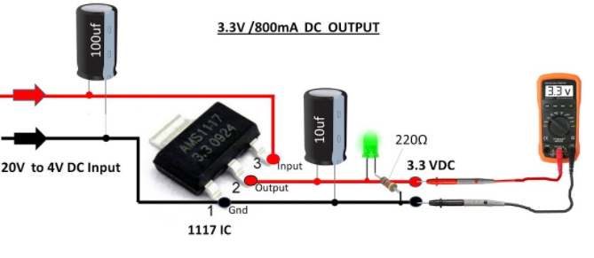

LM1117 voltage regulator x1: https://www.aliexpress.com/item/1005004321246364.html?spm=a2g0o.productlist.main.3.614260e3xVZO5V&algo_pvid=05ef8930-0460-44c5-a3e4-3fc416afe9f3&aem_p4p_detail=202302200928516601291172728800002126362&algo_exp_id=05ef8930-0460-44c5-a3e4-3fc416afe9f3-1&pdp_ext_f=%7B%22sku_id%22%3A%2212000028747228148%22%7D&pdp_npi=3%40dis%21EUR%215.47%213.5%21%21%21%21%21%40212272e216769141313254951d06e3%2112000028747228148%21sea%21NO%212160084717&curPageLogUid=p38zBN39tRtn&ad_pvid=202302200928516601291172728800002126362_2&ad_pvid=202302200928516601291172728800002126362_2

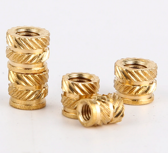

Heat inserts M2 x3: https://www.aliexpress.com/item/1005004624377733.html?spm=a2g0o.productlist.main.1.75f864286jYy5E&algo_pvid=b64181d1-bf0c-4f75-a0b3-0406e70afe0c&aem_p4p_detail=202302201304563148468652295900002830455&algo_exp_id=b64181d1-bf0c-4f75-a0b3-0406e70afe0c-0&pdp_ext_f=%7B%22sku_id%22%3A%2212000029877028144%22%7D&pdp_npi=3%40dis%21EUR%211.05%210.89%21%21%21%21%21%40212244c416769270966878847d070d%2112000029877028144%21sea%21NO%212160084717&curPageLogUid=3ngfsJN6FgqB&ad_pvid=202302201304563148468652295900002830455_1&ad_pvid=202302201304563148468652295900002830455_1

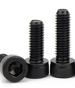

M2 x6 and up socket or button head: https://www.aliexpress.com/item/32810872544.html?spm=a2g0o.productlist.main.1.5a3e5e8eRSg80S&algo_pvid=0907f467-27fa-4930-8df2-85bb182374e9&aem_p4p_detail=202302201308232627818458345820014218738&algo_exp_id=0907f467-27fa-4930-8df2-85bb182374e9-0&pdp_ext_f=%7B%22sku_id%22%3A%2212000026955302077%22%7D&pdp_npi=3%40dis%21EUR%211.8%211.43%21%21%21%21%21%40211bd4cd16769273034514407d06b4%2112000026955302077%21sea%21NO%212160084717&curPageLogUid=y4Cv59e7JkpE&ad_pvid=202302201308232627818458345820014218738_1&ad_pvid=202302201308232627818458345820014218738_1

Cut prototype pcb board to right size, 7x12 holes.(20x32 ish)
It can be done quickly by scoring it with a knife along the holes at both sides, then brake it off in a wise.

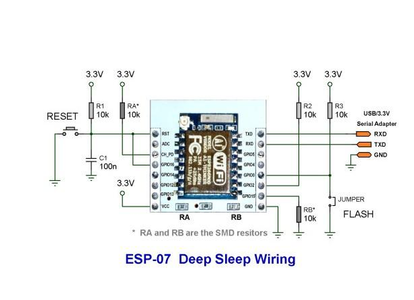

Place 4 resistors under the esp module. se picture for referance.
Solder them. the top ends near esp, should all be connected to esp`s vcc.
The 5th resistor is mounted from other side crossing the 4 resistors, ending next to start/end of the 4 resistors.
5th resistor is ment for a pulldown resistor for gpio 15. (ref.esp wiring picture )
The capacitor in the wiring picture can be ignored.
The voltage regulator (117.3,3) should be at center on back side (esp facing down)
Solder it, and add the capacitors. (ref. voltage regulator picture)
Connect wires for power in/out of regulator now.
Connect 3,3v power to esp.
Now you can do the esp wiring (ref esp wiring picture)
Wire your servo power to voltage in(5v) at regulator, gnd to gnd. Signal to Gpio 14
