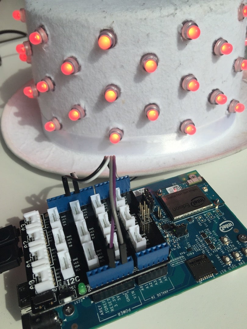

Step 15: Connection the Edison Via SPI to the LEDs
Serial Peripheral Interface (SPI) is way to connect different hardware devices and sending information over the connection.
To connect LEDs of the type WS2801 to the Edison, two wires for signal and two wires for power are needed.
  1. + 5 Volt (5V)
  2. Ground (GND)
  3. Data (MOSI = Master Out Slave In)
  4. Clock (SCK = Serial Clock)
The corresponding pins on the Arduino connectors of the Edison are:
  1. 5V
  2. GND
  3. Pin 11 (MOSI)
  4. Pin 13 (SCK)
II used four jumper wires to connect the Edison to the LEDs, which have a four pin JST SM connector at both ends of the string. One connector at the LEDs is for input and the other for output. The output is needed, if you want to connect more than 50 LEDs. Using many LEDs might draw too much power.
Each LED is marked with an arrow symbol showing the direction from input to output. I only connected the input.
Step 16: Isolating the Power Wires of the LEDs
In addition to the JST connectors there are two loose wires for power at each end of the LED strings. These are additional power wires are indented for large installations with many LED strings, where you definitely need to supply power at more than one point. Otherwise the last LEDs will get a lower voltage and light up darker and more reddish.
I connected the power wires of the same color from both ends, which each other. Otherwise blank wires would be laying around and would be sooner or later cause a short circuit, which might damage a lot.
So a cut two 2 cm pieces with scissors from a roll of a heat shrink tube with 2 mm diameter. Then pushed one wire end trough the tube and soldered the wire together with the other wire of the same color. After this I pulled the tube to the middle of the connection to isolate it. A temperature around 90°C will shrink the tube to fix it. If you do not have a hot air gun with that regulated temperature, a hot air hair dryer could also work, but not so easy.

To see the small web page which is produced by that sketch, you need have a computer or a phone with browser. I that browser you enter the name or the IP address of your Edison.
Instead of toggling one LED on or off, I modified the code so, that all 50 LEDs could be switched Red or Green.
Step 19: Changing the Animation of the LEDs Wirelessly Via Phone
I the above picture you see, how the screen of the phone looks like, when connecting wirelessly to Edison.
I made five links. One to switch all LEDs off and four other links to switch between four different animations.
As mobile power supply for the Edison and all LEDs I used one rechargeable USB battery. I measured a power consumption of about 300 mA, so it can run for hours.
For practical uses of this WIFI enabled LED Hat I see some problems:
  1. The Edison with the Arduino Kit is much too big to be a truly wearable device. Even the too big Arduino Uno is much smaller.
  2. The Edison gets hot. You do not want that near your head.
  3. You have to wait for the operating system of the Edison to boot and to connect to the WIFI, before you can use it. A usual Arduino starts without noticeable delay.
  4. You are limited to the area of one WIFI network to control it via phone. This makes it difficult for the use on bicycles.
  5. Booting the Edison into the Arduino Sketch did not work reliable. If it did not work, I hat to upload the Arduino Sketch again.
