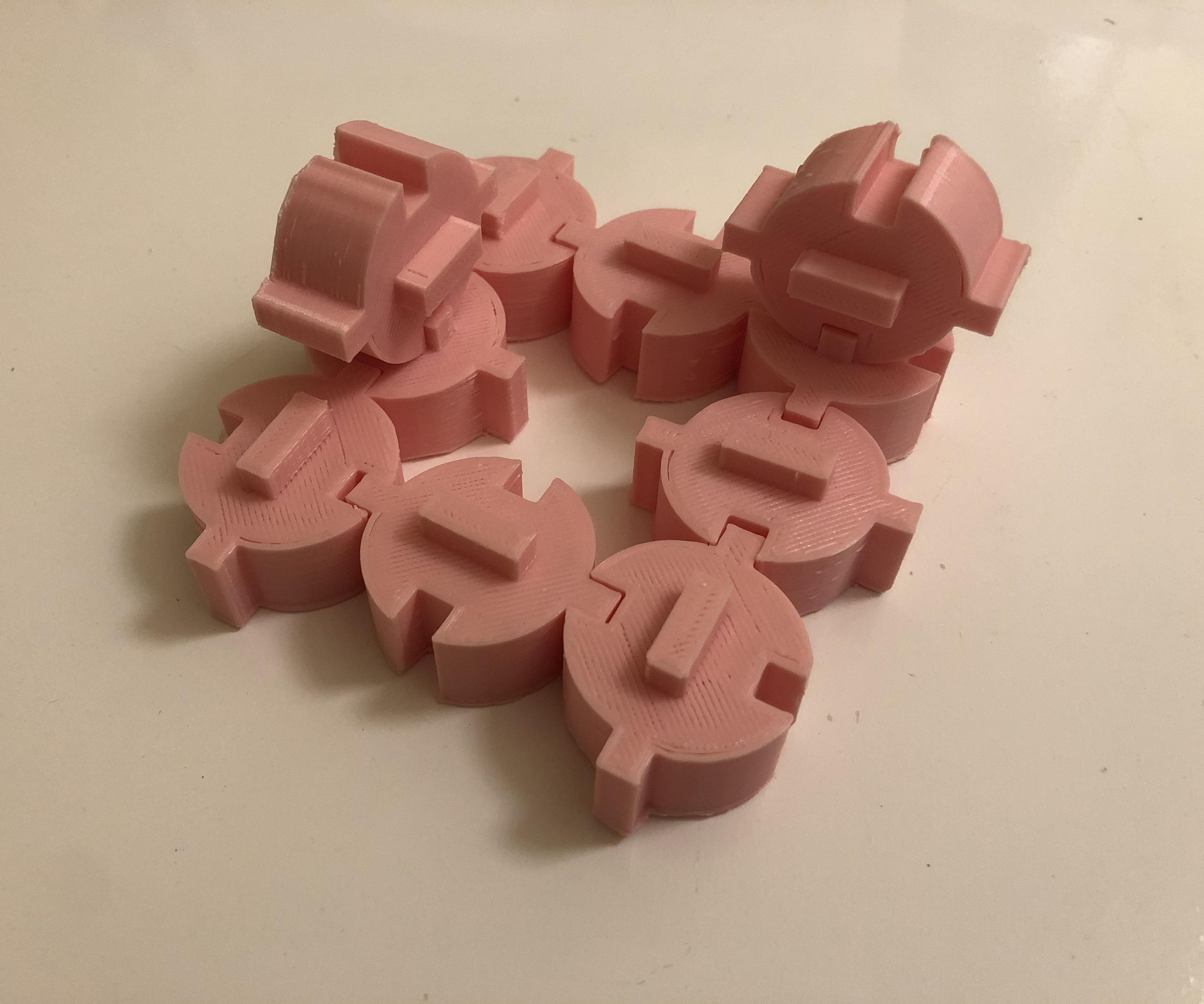

Step 7: 3D Print Test With Several Image
These are outputs of 3D printed cookie stamps based on the drawn design.
It works even in the camera captured drawn design on the paper.
The key point to design is
  1. Draw big & clear image
  2. Use white background and a 1:1 size ratio is the best
  3. Use a thick pen (In computer draw 2pt line width is guaranteed to print)
