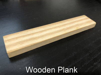

  • Superglue or Hot glue gun
  • Toy wooden planks (can just use 3d printed material for this instead)

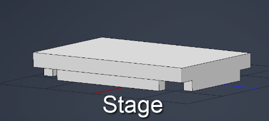

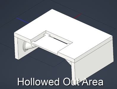

Step 9: Adding the Stage
After the base of the bridge was made, I hollowed out an area on the bridge in order to fit the stage on top. Next, I cadded a stage that fits into the area, with the ability for it to slide up and down in mind.

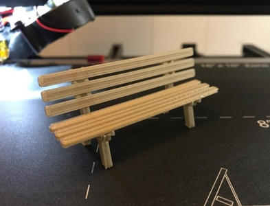

Step 12: Decorations
I found a suitable model for a bench on Thingiverse: https://www.thingiverse.com/thing:1978492

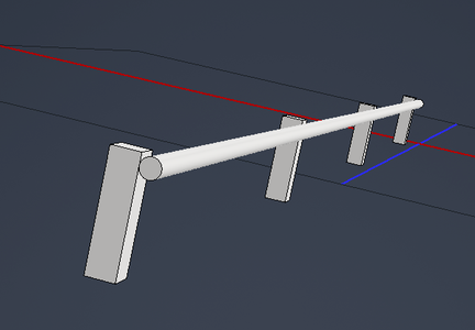

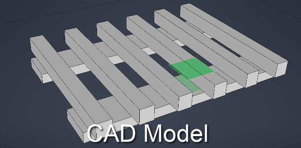

Step 14: Railings (Decorations)
I Cadded a small rectangular prism for the railings, with the intention of making a few of these, then using 3d printer filament on top to connect them together and form a railing.

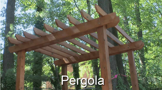

Step 15: Improve
I was out biking on a really hot day, and I happened to cross a bridge. Through this, I realized that a great way to improve the bridge would be to add a shade/cover for really hot days. A quick Google search about types of shades led me to the pergola. I came up with the idea of adding interlacing vines and plants over the pergola as some sort of leaf cover for shade, this would improve the shading performance of the pergola, and it would make it more eco-friendly through the integration of nature.
Step 16: CAD the Pergola
I was originally going to 3d print this as well, but my 3d printer unfortunately broke, and waiting for the replacement parts for fixing it to arrive was going to take too long, so I had to get creative. After looking around to see what I had to work with, I found some toy wooden planks and a hacksaw, and I could use those to cobble something together. I cadded out a design and cut the wood planks to the desired sizes, then attached the pieces together with a hot glue gun.

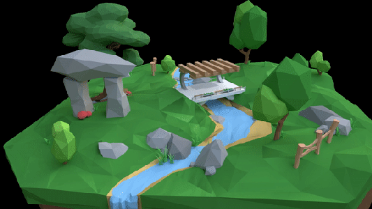

Step 17: Putting It All Together
Renders of the finished bridge, I got the render backdrop from: https://skfb.ly/6CvwR. Imported the CAD files into Blender (3d computer graphics software) and applied materials to them to get the final render result.
The CAD file for the finished bridge is attached to this step.

Step 19: Retractable Stage
Render and photos of the stage in elevated and lowered position.
