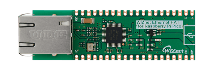

Overview

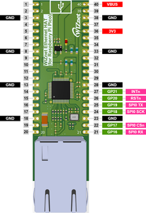

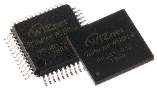

WIZnet Ethernet HAT (Hardware Attached on Top) is a Raspberry Pi Pico pin-compatible board that utilizes W5100S and supports both 3.3V & 5V.
Please refer to this link to find more information about W5100S.
- Raspberry Pi Pico Pin-Compatible
- Ethernet (W5100S Hardwired TCP/IP CHIP)
- Product page : https://docs.wiznet.io/Product/iEthernet/W5100S/overview
- Support 4 Independent Hardware SOCKETs simultaneously
- Support SOCKET-less new Command: ARP-Request, PING-Request
- Support Auto-MDIX only when Auto-Negotiation mode

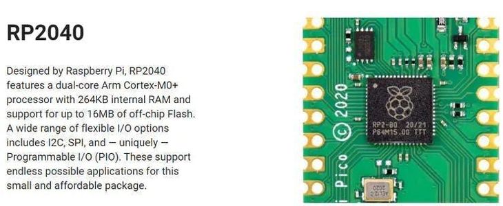

RP2040 Datasheet - https://www.raspberrypi.org/documentation/microcontrollers/raspberry-pi-pico.html

Prepare Hardware
1. Combine WIZnet Ethernet HAT with Raspberry Pi Pico.
2. Connect ethernet cable to Ethernet HAT ethernet port.
3. Connect Raspberry Pi Pico to desktop or laptop using 5 pin micro USB cable.
- If you use W5100S-EVB-Pico, you can skip '1. Combine...'

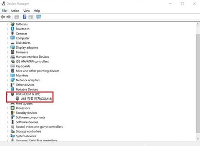

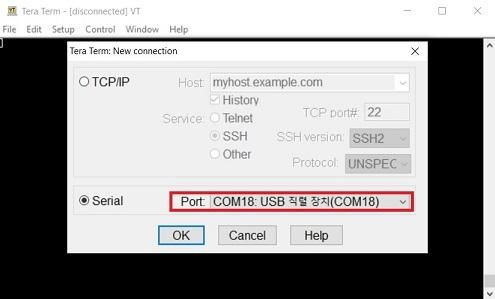

The following serial terminal program is required for HTTP Client test, download and install from below links.
Before this, you should find the Raspberry Pi Pico COM port number from "Device Manager" on your PC.

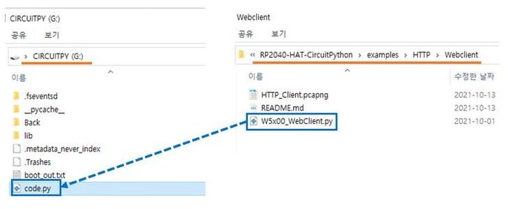

Step 3: How to WebClient Example
Setup WebClient Example - download https://github.com/Wiznet/RP2040-HAT-CircuitPython/tree/master/examples/HTTP/Webclient

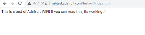

- Press "Ctrl+D" on the terminal window. you can see the messages as follows.
-Use DNS to access the address of the server. After that, it accesses the server in each URL and prints the contents. The text of each URL is as follows.
Step 4: HTML Server.
- It is the original text on the HTML server.
