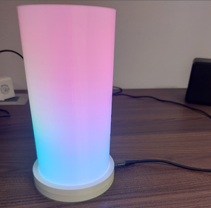

Add a splash of color to your workspace or living area with this simple cylindrical mood light! Powered by a D1 Mini (with USB-C) running WLED, it uses four short LED strips (each with five LEDs) to produce vibrant, customizable lighting effects. I’ve provided the (very simple) 3D models in both STL and STEP formats, so feel free to tweak the design or reconfigure it to your heart’s content. In this Instructable, I’ll walk you through each step of building your own dazzling mood light—from assembling the electronics to printing the enclosure—so you can quickly brighten up your space!

Save these settings to apply them. The D1 Mini will reboot and if all the LEDs are orange, all is well.
Finally, place the diffuser (you can glue it in place, I chose not to) and explore the effects in WLED.
