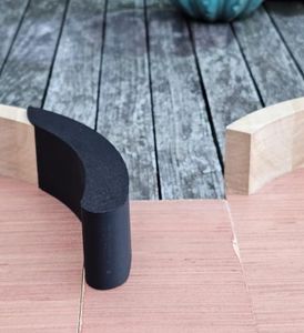

Step 9: 3D Printing
In this step, both items will be 3D printed.
Tools needed:
- 3D printer
- 2x Step file
