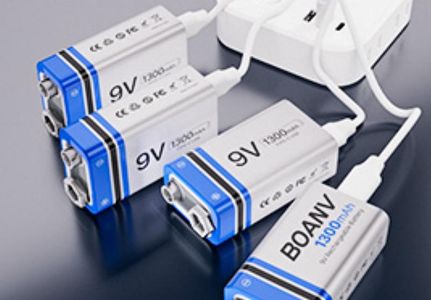

I found these rechargeable 9v batteries that work well. You have to remove the battery cover and the rear screw. Cut a chunk out of the remote case and some notches by worrying the plastic with a pair of pliers as shown.
This batch of rechargeables came with a double adapter to charge the battery in the remote and an extra battery simultaneously.
