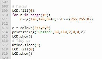

Here the final switch is tested and then we look to see if switches A and Y are pressed together, the condition to terminate the looping. If so, running is set to False and we drop out of the loop.
We then start the 'tidy-up' sequence. A series of concentric rings are drawn in yellow and 'Halted' is displayed for 3 seconds before the screen is cleared to black and the execution stops.

Step 10: Finishing Off
We drop out of the menu loop to this section. It displays the HALTED screen in a wide yellow circle and then shuts down the screen.
